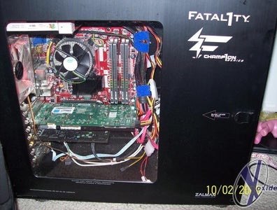

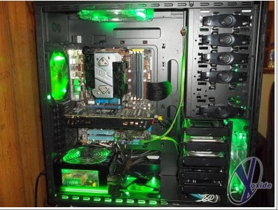

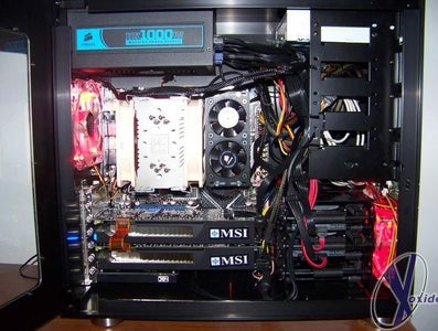

Step 1: How NOT to Do It
These pictures severally piss me off because they are $250+ cases that have rat nests in them.
WHY PEOPLE WHY!!!!! Such good cases ruined by ignorance and stupidity

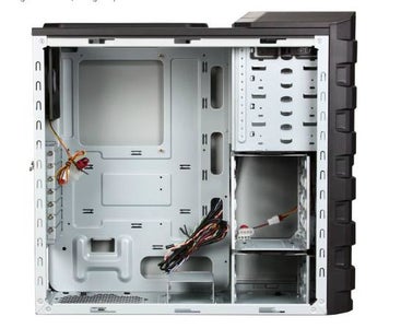

The 2 main things that determine how well you can hide all of your cords and wires are your computer case and your power supply.
When choosing a case check for openings around where the motherboard will be placed, generally the more openings there are the better. Cooler Master cases are widely known for excellent cable management and for high air flow. Also the room behind the motherboard mounting plate the better because you can stuff more cords behind that plate.
Personally I chose a Cooler Master HAF 912 because it only cost $60 and with all the components I ordered to put in my rig, I was just barely getting into quadrupal digits on my build. Later I bought an optional side window for it from Cooler Masters website. Another reason I chose this particular case was the easy to remove front plate were I could hide yet more wires.
The second thing is the power supply (PSU), normally you want something with high quality nylon braiding or wires that are of you color preference that has detachable PCI-E and peripheral SATA/molex cables because there is no need for more cables than you actually need. Keep in mind that a PSU can last you for your next build or maybe even the build after that given that cable standards don't change by then, so choose something that suits what you would like do with it in the future. I chose a Raidmax 850W PSU with detachable cords that can handle SLI and it wasn't as expensive as a Corsair

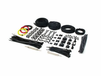

Other small things you will need are:
-zip ties [they are the standard but more permanent than other solutions]
-twist locks
-wire clips
-twisty ties [like you use on produce bags in grocery store, they are easy to use over and over again]
-spare wire of assorted colors
-soldiering iron
-soldier
-heat shrink
-sleeving
-gorilla duct tape [looks good and hides cables that are behind motherboard mounting plate, plus it can hold cables in awkward places]
-electrical tape
-pliers
-wire strippers
You can also buy extensions but they get pricey fast.

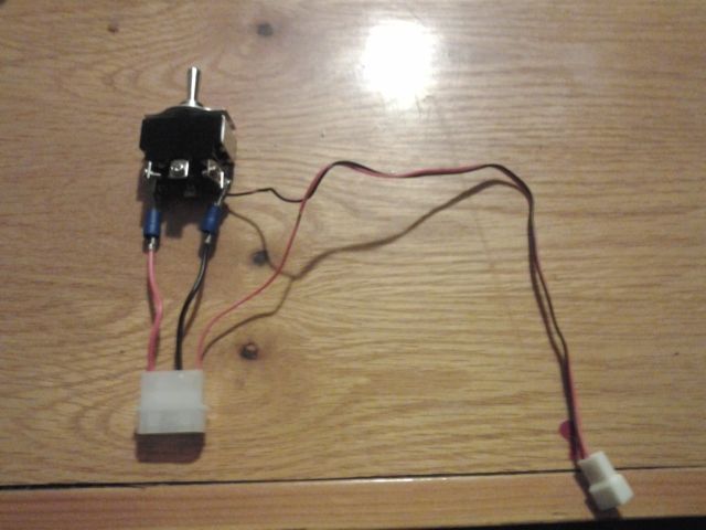

I had 3 fans that needed to reach to molex down in the HDD cage so i attached 3 of them together and ended up making my own molex adapter to save wire and space. Unfortunately i ran out of heat shrink so used twist caps, when i have the cash ill do it it right.
In the other picture there is a light on/off switch connected to a molex and a and a connector. Unfortunately I didn't have my electrical box on me or I would include the lights in this instructable, I will add them later.

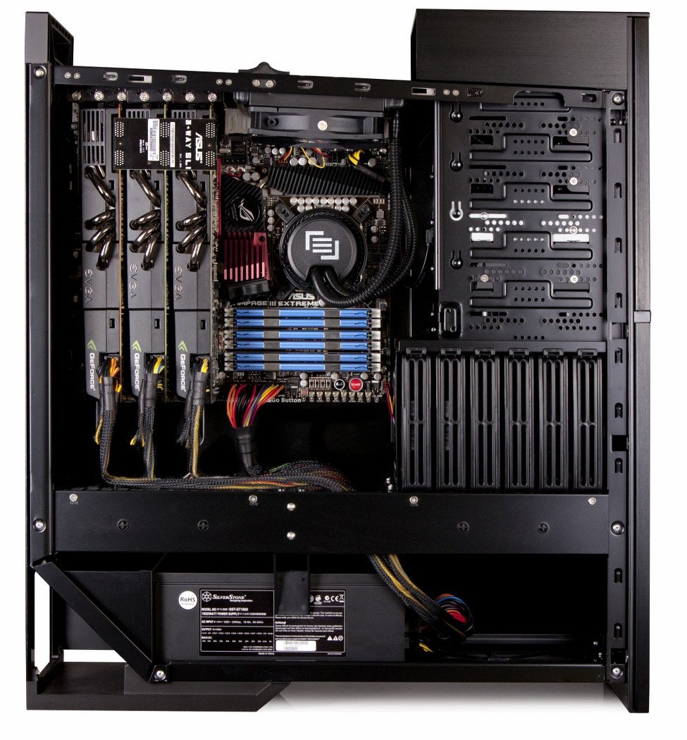

Step 11: What I Would Do With More Time and Money

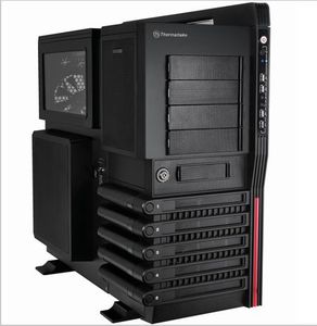

If I had the dough i would like to get a really nice case like Zalman Fatility, Thermaltake Level 10GT, or I would convince Maingear to sell me one of their custom cases. I certainly wouldn't use duct tape for most of my build if I had the cash and I would definitely spend some time making my own cords and extensions.
What do the pros do differently? They paint the insides of their cases, use extensions and add a few flashy things that take the eyes off of cords like bright liquid cooling items, flashy reservoirs and a logo that really stands out.
I would like to stick a show stopper GPU in it like an asus ROG MARS II, an ROG z68 mo-bo, a PCI SSD, liquid cooling and other things but i only have $300 to my name so this are all very distant dreams ='[
