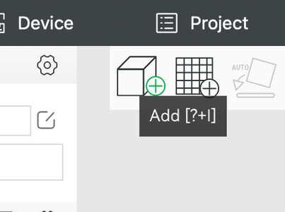

If you are uploading the model from a 3d Modelling software, download the file in one of the working formats (I've found 3mf works very well). Then, in BambuStudio, select "Add" by navigating your mouse to it or by pressing cmmd/ctrl + I. Select find the file you need, and import it.

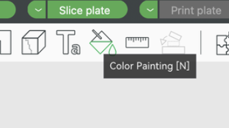

Step 3: Colour Painting
Select "Colour Painting" with your cursor or by pressing N. This gives you access to the paint tools in the 4 different colour of the filament you have loaded in your AMS or AMS lite.

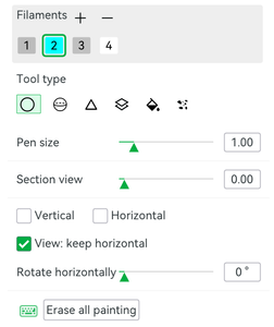

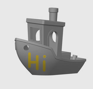

Step 5: Circle Tool
The circle tool is the best tool to use for detail and small, precise adjustments that deviate from the general shape of the print, such as any designs or decals. By changing the size of the pen you can achieve more or less precision depending on what you're painting. This tool is especially useful in order to fill in smoothed or corners that would be missed by the fill tool.

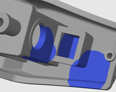

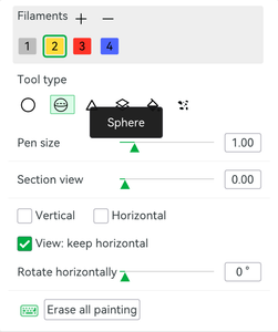

Step 6: Sphere Tool
The sphere tool allows you to place a sphere of any size decided by you using the scalar anywhere on your model. Anything inside the sphere will be painted that colour. Can be utilised to easily fill the inside of models, as well as painting the supports and internal walls of the filament.

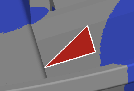

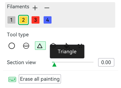

Step 7: Triangle/Polygon Tool
Allows you to colour individual polygons on the surface of your model, can be useful for large, flat surfaces. Not the most practical tool but can also find uses for it for filament painting.

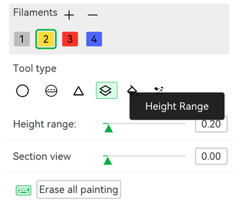

Step 8: Height Range Tool
The height range tool is one of the most useful tools, it allows you to completely paint a section of a by deciding a precise height range. This tool can be used to great effect to precisely paint certain areas of models. For example, painting the sea level of a model coastal city.

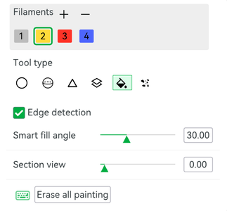

Step 9: Fill Tool
The fill tool is the most useful tool for painting in a hurry. It allows you to completely fill an area of your model depending on the sharpness limit of the angles. By changing the limits of the angles, you can change the precision of the fill tool. This has many applications in general model painting, as well as filament paintings.

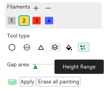

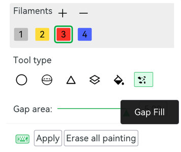

Step 10: Gap Fill
Gap fill is a tool that will fill in any thin gaps between your walls automatically, you can change the minimum gap size to decide what should be filled in if you wish to leave intentional gaps. This can be good for certain models which may have unwanted gaps. It can also be disabled if you are making a highly intricate model with many necessary and intended gaps.

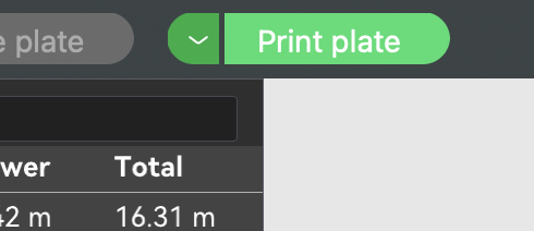

Step 11: Printing Your Model
Once you finish painting your chosen model, press exit colour paint by pressing N or the escape key. Slice your plate, and send it to print. Check on your print occasionally to ensure that no printing failures have occurred and simply wait for it to finish.

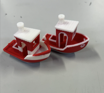

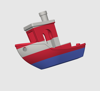

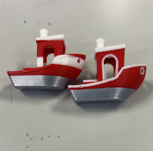

Step 12: Examples
By playing around with these tools, you can add colour and aesthetic appeal to your prints. For an example, take a look at the 2 benchies I made using these tools, but there are far more impressive and intricate things that can be made with these relatively simple tools.
