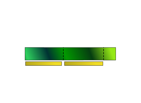

The picture shows a blank marked out to accept the brass tubes for the Round Top European hardware. Leave a little extra material on each blank segment, it doesn't have to be flush with the tube at this point. Once that's done, it's time to cut the blanks. I find that the best tool for this is a band-saw because of it's thin kerf (blade width).

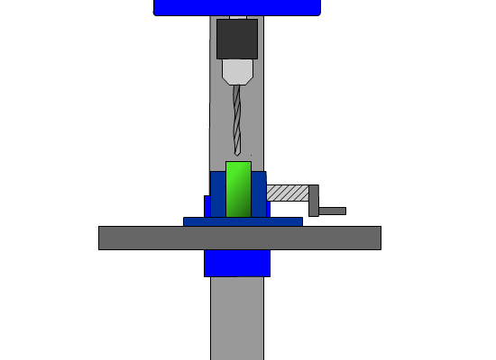

Using a 7 mm drill bit mounted in a drill press, I drill a hole in the center of the barrel blank that goes all the way through. It's important that the drill bit is bought out frequently to clear the flute. This will also prevent the blank from being damaged. A "Quick-Grip" clamp is used to help hold the blank steady during the drilling process. If you have a vice for your drill press, I recommend using it (like the diagram shows).

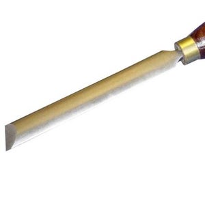

Now the the pen has been rounded a bit you can start on finishing the barrels up. I start with the top one. To achieve the smooth finish on the acrylic necessary for a scratch-free finish, you will need to know how to bevel a skew chisel to make fine sheering cuts. The video I made shows the proper method for making these cuts. Hold the tool so it has a substantial amount of support. Then touch the bevel to the work-piece and lean it into the material and begin shearing off fine shavings. A tennon is also cut (to accept the center-ring) using a parting tool and the sizing ring (the largest of the bushings). When the sizing ring fits over the tennon snugly that means the center-ring will fit well too. The rest of the Barrel is shaved down until it's just about flush with the sizing ring. Remember not to make this too close of a fit since sanding needs to be done.

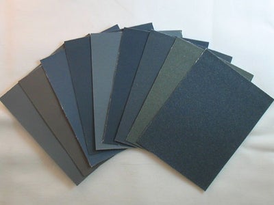

One of the most difficult parts of turning acrylic is achieving a smooth, scratch free finish. During the sanding process, I start with 150 grit and finish with 12000 grit. The order of how I sanded goes like this: 150, 200, 400, 600, 1500, 1800,  When I get up to 1500 grit I start using Micro Mesh sheets. The Micro-mesh sheets I used can be found here. The most important part about polishing is to not apply a ton of pressure. Sand very, very lightly. Back the micro mesh sheet up with a paper towel if necessary.
