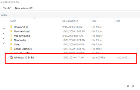

Get/Download the Windows 10 ISO File.- https://www.microsoft.com/en-us/software-download/windows10

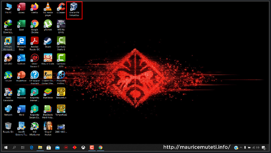

Step 4: 4. Start Virtualbox.(launch the Software and Click New in the Manager Window.)

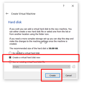

Step 8: 8. Create a Virtual Hard Drive. on the Following Screen Choose to 'Create a Virtual Hard Drive Now' and Click Create.

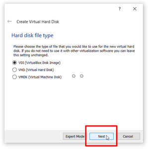

Step 9: 9. Accept VDI (VirtualBox Disk Image) As the Hard Drive File Type.

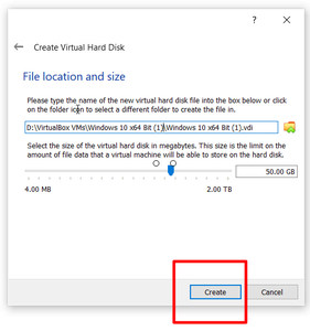

Step 11: 11. Enter File Location or Leave the Default Location and Select the Size of Virtual Machine in Megabytes. Then Click Create and VirtualBox Will Begin Building the Drive.

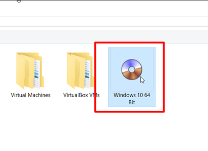

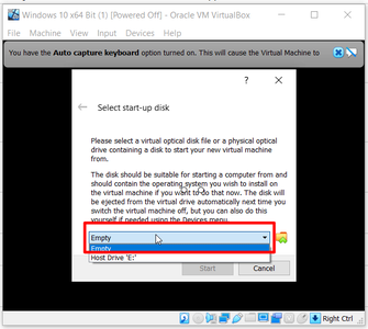

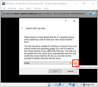

Step 13: 13. Select Your ISO As the Startup Disk. in the 'Select Start-up Disk' Window, Click the Folder Icon and Navigate to the Windows 10 ISO.

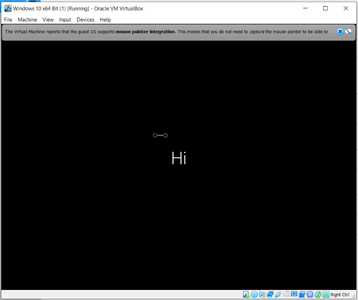

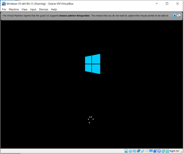

Step 14: 14. Click Start and Windows 10 Should Begin to Load.

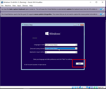

Step 15: 15. Select Your Language Settings.

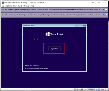

Step 16: 16. Click the 'Install Now' Button.

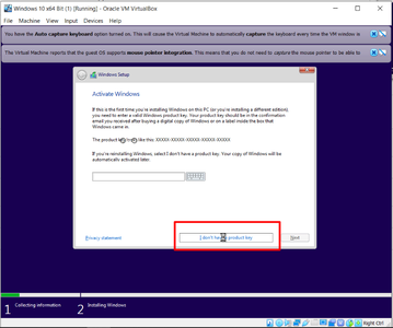

Step 17: 17. Activate Windows by Entering a Product Key.
Activate windows by entering a product key. If you don't have product key click "I don't have a product Key". (You'll be prompted to enter your license key but you can skip this step for now (useful if you don't actually have a Windows 10 key). Otherwise enter The Product Key.)

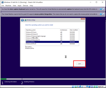

Step 18: 18. Select the Operating System You Want to Install and Click Next.

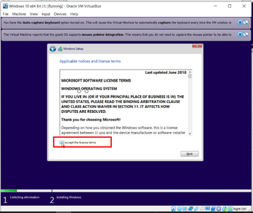

Step 19: 19. Accept the License Terms.

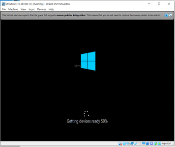

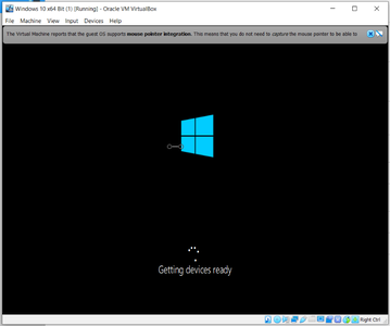

Step 25: 25. Getting Device Ready.
Step 26: 26. Just a Moment.

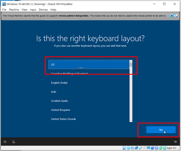

Step 28: 28. Select the Right Keyboard Layout and Click Yes.

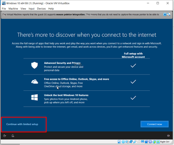

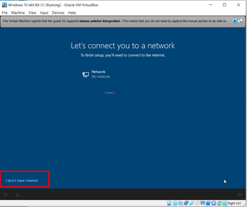

Step 30: 30. Connect to the Network or Choose "I Don't Have Internet".
Step 31: 31. Click "continue With Limited Setup" or Connect Now.

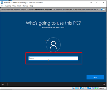

Step 32: 32. Enter Username Then Click Next.

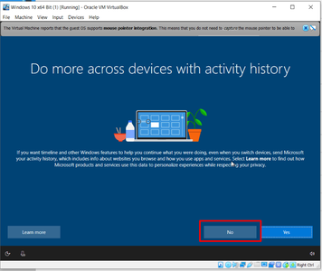

Step 34: 34. Choose No or Yes to Continue.

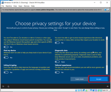

Step 35: 35. Choose Privacy Settings for Your Device and Click "Accept".

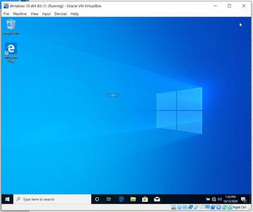

Step 36: 36. Windows 10 Will Finalize Everything and You Can Begin Exploring.

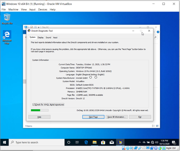

Step 37: Installation Complete

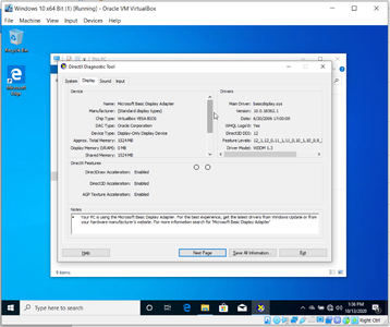

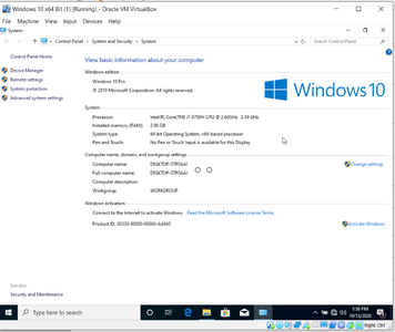

Step 38: Check Computer Properties for Your Windows 10 Operating System
Step 39: Finished Installing Windows 10.
