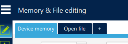

Step 5: Open STMCubeProgrammer and Connect to STM Board Via USB
Step 6: Click on Open File and Paste the Copied Path
Step 7: Go to Download Options (Found in Toolbar on the Left)
Step 8: Configure Download Settings and Activate Automatic Downloads
