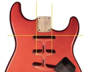

Step 2: Cut the Guitar Body
This is a crucial step and as all good craftsmen will say: measure twice and cut once.
Some advice is to cover the area to be cut with masking tape to avoid the chipping of the guitar body paint. This paint usually is very thick and tends to chip easily.
There are 3 basic cuts to be made are marked with yellow lines in the photo:
- First you need to separate the two horns from the main body, using the end of the neck pickup routing pocket as a reference.
- Cut the upper horn at 90º from the previous cut
- Cut the lower horn at 90º from the previous cut
