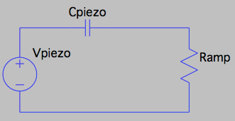

A piezo element operates like a voltage source in series with a capacitor--when the piezo crystals vibrate, they produce a voltage. This voltage may be high, but the current is very small. Because of the series capacitance (Cpiezo), virtually no DC current flows through the piezo. The input of an amplifier acts like a resistor to ground (Ramp), known as its input impedance. Together, Cpiezo and Ramp form a high-pass filter that cuts out low frequencies. For typical values of Cpiezo and Ramp, the cutoff frequency is well into the audible playing range of a guitar. In order to reduce the cutoff frequency so that more bass tones get through, we need to increase the input impedance that the piezo is driving. This is where a preamp comes in. The role of the piezo contact mic preamp isn't really to amplify the signal (the output voltage of the piezo is plenty high), rather the goal is to provide a buffer with a very high input impedance of 10M ohms or so, which is more than 10 times or so greater than the input impedance of a typical guitar amp, so that more of the bass gets through. It also provides more current to drive signals on the cable to the amp, which can also improve the highs.

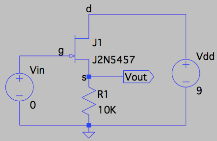

As a starting point to understanding the complete preamp, let's consider a simpler version shown below:
A JFET has 3 terminals called the gate (g), drain (d), and source (s). In general, increasing the voltage Vin on the gate of the JFET causes an increase in current flowing through the device from the drain to the source. Having nowhere else to go, the current flows through the source resistor R1, which in turn produces a voltage across R1 (remember Ohm's Law, V = IR), causing the output voltage Vout to also increase. One of the unusual things about a JFET is that if the input voltage is 0, meaning that the input is grounded, there is still a current that will flow from drain to source, and you actually need to apply a negative voltage to the gate to turn the device off. The plot below shows the relationship between the input voltage Vin and the output voltage Vout, given a supply voltage Vdd = 9V and a source resistor of 10k ohms.
Note that when Vin = 0V, Vout = 1V, indicating that current is flowing through R1. Vout goes to 0V when Vin is around -1.25V, which is the point where the JFET turns off. In the range between Vin = -1.25V and Vin = 7.5V, Vout increases linearly with Vin. In fact, for every increase of 1V of Vin, Vout also increases by 1V. The ratio of the change in Vout over the change in Vin (the slope of the line) is the gain of the amplifier, which in this case is just equal to 1.
This configuration of an amplifier, where there is a resistor connected to the source of the JFET and the output voltage "follows" the input voltage, is called a source-follower. The value of the source resistor affects the gain of the amplifier slightly. If the value of this resistor is high enough, the gain will be very close to 1 and if the resistor is smaller, than the gain will be somewhat less than 1. I've seen designs on the web where the size of this resistor ranges from 1k ohm to 220k ohm. If the value of the resistor is too high, it will heat up (slightly) as current passes through it, which can result in noise. 10k ohm is a good middle-of-the-road value. You may also see some preamp designs on the web where there is also a resistor connected to the drain of the JFET. This style of amplifier is called a common-source and generally has a gain greater than one--that is, the change in output voltage is greater than the change in input voltage--true amplification. This can be useful for an electric guitar with coil pickups, but since the voltage output of a piezo contact is already high enough, this isn't really necessary in our case.
When Vin is greater than around 7.5V, Vout starts leveling off at a little below 9V. This is because the JFET is turned on as far as it can go, and any further increase in Vin won't produce any additional current through the device. More technically, the JFET stops behaving like a current source controlled by the gate voltage and starts behaving more like a resistor. Note that the transition into this region of behavior is much more gradual than the behavior at the other end, where the JFET shuts off more abruptly when Vin drops below -1.25V.

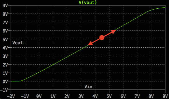

Avoiding Distortion: The Purpose of the Gate Bias Resistors R1 and R2

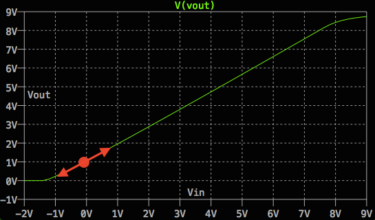

What does this leveling off at extreme low and high input voltages mean in terms of the sound quality of the amplifier? A piezo contact microphone on a guitar produces a signal that varies plus and minus above and below 0V, that is, to either side of the red dot in the graph above. As the input to the amp changes, the output changes smoothly with it. If the input dipped below -1.25V, however, the output would be "clipped" at 0V. This causes distortion in the sound, which is sometimes desirable, but generally not for a preamp for an acoustic guitar. If somehow the input signal got above 7.5V, it would also get distorted, but this would happen more gradually. This type of gradual distortion is one of the prized properties of tube amps for electric guitars, which many players feel has a nice "warm" sound.
How likely is it that the voltage produced by a piezo contact mic will dip below -1.25V? Depending on how the contact mic is attached to the guitar, it can happen when you play hard, but for the most part from our experiments, the signal from the mic stayed mostly in the range of plus or minus 0.5V. There is a very simple fix, however, that can give the input signal more headroom by shifting the middle operating point to a higher voltage, as illustrated in the plot below.
This is the purpose of R1 and R2 in the schematic at the top of the section. If we only had R1, the operating point at the input of the amplifier would be 0V. But if we add R2, which has the same resistance as R1, the two resistors act to both pull the input up towards Vdd = 9V and down towards ground with equal strength, resulting in an operating point bias voltage equal to Vdd/2, or 4.5V. In practice, we've found that leaving R2 out is generally okay and we don't get much distortion. Most of the contact mic preamp designs that I've seen online just leave the bias voltage at ground and omit R2, but moving the bias point closer to the middle of the "safe" range just adds one more resistor. The values for R1 and R2 should be at least 10M ohms--remember that the whole point of the preamp is to provide a high input impedance and you wouldn't want to compromise this with a small resistor! Using resistors over 22M ohm doesn't really add any value.
