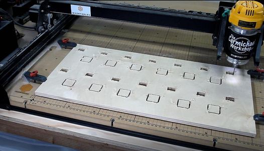

Step 2: Cut Holes in the Top
My drawing includes a hole pattern that will work for standard single pedals. These pedals usually have jacks on the sides and top for the guitar signal and power cables. The holes allow you to run the cables under the board. This pattern also works with double-size pedals that can cover two single spaces. If you don't have a CNC, then you can just drill the holes into the top.

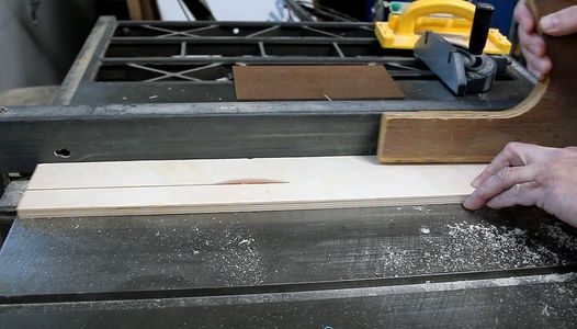

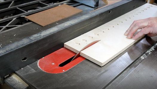

Step 4: Cut the Front and Back Sides
The front and back sides are 23.5" long to allow for an overhang. Since the sides are angled, I marked the angle on the front side and made that 7 degree bevel cut with the table saw. I used the offcut to make the smaller back side, since it already had the 7 degree cut on it. I just had to mark where to make the straight cut to size.

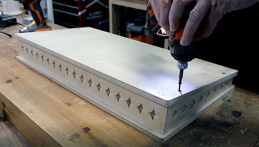

It is real easy to make a mistake and glue the top and sides up wrong, so plan this glue up carefully. First, I glued together the four sides with the front and back pieces overlapping the sides. Once that dried, I glued the frame to the underside of the top making sure the overhang was even around all sides. Be very careful to glue the frame and top together the correct way. You don't want to glue the top on upside down, or reverse the frame.
Step 6: Apply Finish and Attach the Bottom
This is a good time to apply a finish or paint as desired. I sprayed it with Satin Deft Clear Wood Finish lacquer. Drill pilot holes with countersinks, then use 1" screws to attach the bottom to the enclosure.
