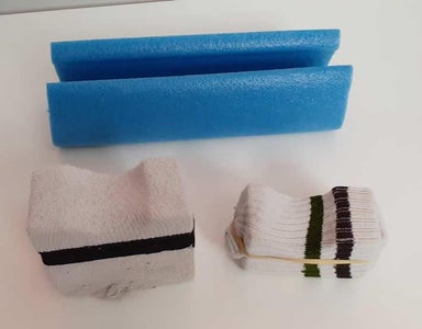

Cut a your 5cm(50mm) panel into a block approx 11cm by 11cm (8cm x10cm for small version) try and keep the base as square as possible. Pencil in a curve cut for the neck and then use a saw to V cut the bulk of the recess. Use your round file to smooth it out a little, now you can test fit it with the guitar, and file the recess to suit the angle the guitar sits. The cuts don't need to be perfect as long as the neck seats well in the saddle cut.
I found at this stage the curve cut needed a little more angle so I filed that, then the neck became very stable. At this stage its totally functional if you want to finish it off a little better then you can do some sanding or goto step 2 doing a sock wrapping. I made 2 versions a small and a large.
TIP: The support has direction that follows the neck angle so if you find it is not as stable as you though just spin it 180 degrees.
TIP 2: A dual height version can be made using a more rectangular shape and adding a second curve cut to the longer side.
Step 3: Step 2 Finishing With a Sock + Elastic
If you want a little better finish or are worried about varnish/finish on your neck reacting you can put a sock around it. I used an old sock - or even those airline socks which are super stretchy and free. I made covers from 1 sock. Just turn the sock inside out and use a zip tie to seal the end. I used some automotive electrical cloth tape to finish off or even just an elastic band. This is the 8cm x10cm smaller block version
Step 4: Step 2 Finishing With a Sock + Tape
This is the block larger version 11cm by 11cm with sock cover and the cloth electrical tape.

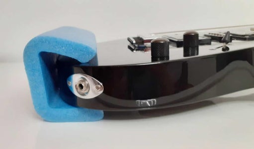

TIP: If you have some u shaped foam this can be put on the base of the body and with the neck support in place your guitar is totally protected. The picture foam is u shaped packing foam the overall size is 95mm wide and 85mm high and 15mm foam thickness.
I will be making a complete travel / lean stand using the u foam so you can check that out.
