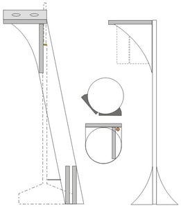

-Structure: I knew I needed a strong base, and I knew that the donor music stand would need some support if it was going to hold up a flat screen monitor. I knew that I would need a surface to use as a mouse habitat, so I designed a plywood assembly that served as a table for the mouse as well as a sturdy structure to which all of the other bits could be mounted.
I did a whole lot of doodling, including a stab at Sketchup... I'll post said doodles when I find said doodles.

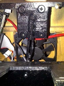

To correct an increasingly leaning neck problem (which actually smooshed the first fan I placed into the sound hole), I added a turnbuckle between the added back panel and a point above the spot where the neck connects.
This proved to be a perfect solution, pulling the neck back into place and allowing the strings too look right (though they will always sound like vomit). An added benefit of this addition: before this change, if someone were to try to turn the tuning keys too far (in a noble but misguided attempt at tuning), the neck would bend more and more and could conceivably break (even before the strings!).
"I see a turnbuckle and I want it painted black..."
-Mick Jagger
I painted it black.

I had some specific challenges with wobbly donor hardware, the need for a mouse surface and the weight demands of the LCD, and I met these challenges with plywood.
The base is just a rectangle. The "table" holding the tambourine is also just a rectangle, but it has a half-circle at one end, cut to fit the tambourine... so I suppose it's a few notches cooler than an ordinary rectangle.
I wanted the main vertical part to be narrow enough so it didn't obstruct the guitar too much, but not so narrow that it was wussy. It is supported by two semi-triangular braces joining it to the base. The mouse habitat is stuck to the top edge of the main piece, and supported from below by another semi-triangular brace.
After the plywood was cut, I patched the imperfections with plaster spackly stuff, sanded, and...
"I see a cumbersome plywood apparatus and I want it painted black..."
-Mick Jagger
The music stand and the guitar stand are both U-bolted to the plywood, and the result is pretty sturdy. Wires are all black or hidden in black split loom tubing (attached by black zip-ties), so painting the plywood black provided a clean finish that camouflages everything (including my shoddy workmanship) nicely...
