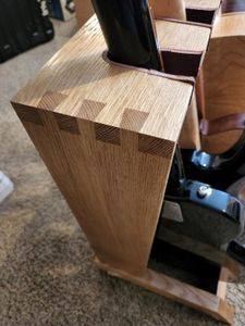

The dovetails are all hand cut. If you are interested in learning how to do hand cut dovetails, I highly recommend Rob Cosman's youtube channel https://www.youtube.com/c/RobCosmancom He's amazing and once you do it a few times you'll never go back to using a router.
Step 4: Test Fit and Glue
Do a quick dry fit to make sure all the parts fit correctly before glueing.

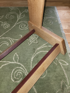

The only parts that are glued are the dovetail peices. The rest are help in place by dowels. I wanted the feet to be able to move and self level on my uneven floors.

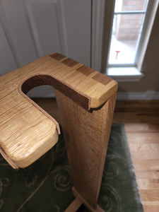

Step 5: Leather
To protect the guitar I add some leather on all the surfaces that touch the guitar.
