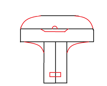

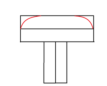

First You need to cut 2 planks into four pieces like on the first schematics. Measure the width that looks good to You. Then by rounding the corners using jigsaw on the red line, we are left with two pieces. Those two pieces we move under the second horizontal piece like on the second picture.
On the first horizontal board that is rounded we drill a hole for the guitar strap screw on the edge of the board (see picture 2). Next to it, on the lower horizontal board, comes the chamfer/edge for the back of the guitar. It is made with the angle grinder with grinding paper plate attached to it. Cut enough for the guitar and the felt that comes on that edge so it does not get scratched.
The 2 bottom vertical boards are first glued together. Then using the router we make a hole for the neck of the guitar stand.The hole must be wide enough for the third plank to be inserted into it. After making the hole with router, we must clean up the edger with a chisel and a hammer for the hole to be rectangular. On the bottom part of this piece we make a small slot for the 3 screws attaching the bottom part and the neck like on the third picture.
Optionally 2 little cubes can be added as a guitar stop ends for the sides of the guitar. We glue them on the bottom part of the stand.
As for the neck of the stand, we carve a slot on the top that fits guitar neck. Make sure You carve a little deeper so it has room for the felt that is glued there so the guitar does not get scratched. Next to that slot I added 2 small end pieces to be sure guitar does not slide to the side. They can be seen on the finished stand photo.
Using the wood glue we glue all the bottom pieces together like on the second picture and we end up with something like on the forth picture.
