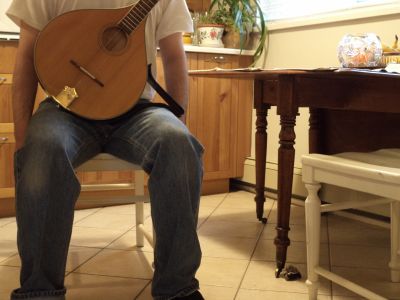

The single suction cup goes toward the top of the body; the end with two suction cups goes toward the bottom.
For banjola, mandola, mandolin, and bousouki, you'll have to play with positioning a little. The geometry is a little different than with guitar because the instrument has one bout. With my banjola, the positioning you see here creates a high angled neck. If you want a lower neck position on a one bout instrument, move the top end of the support up.
I leave the bottom end attached when I put the instrument in its case so I don't have to reposition the support to find the sweet spot. On my banjola, I just remember that the edge of the suction cup is in line with the outer rosette ring. You could also take photos for reference once you've found a couple of good playing positions. The guitar support can sit on your left leg, across your lap, or on your right leg depending on how you like the guitar angled.
