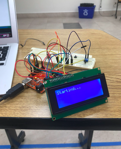

   Lcd.begin(LCD_WIDTH, LCD_HEIGHT);
  Lcd.print("Starting...");
  delay(2500);
  Lcd.clear();

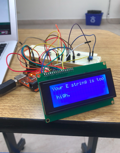

 //LOW E STRING
    if(peak>83.5 && peak<92) {
    Lcd.print("Your E string is too high.");

Step 3: More Pictures
