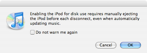

In the previous step the checkbox "Enable disk use" is left unchecked. When you check it a warning box appears informing you of possible doom should you yank your iPod out of the computer connection without manually ejecting it first. Easy peasey, you can handle that. Fire away!

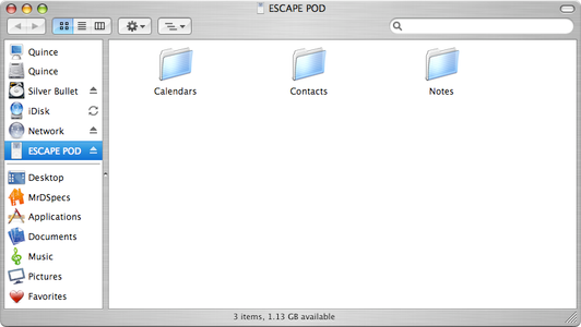

Having enabled disk use, you should wait for your iPod to finish automatically updating before removing it from the connection with your computer. After each automatic update the iPod is immediately ejected from the computer by iTunes, hence the reminder to need to eject yourself. Having disconnected your iPod, the next time you reconnect it to the computer it should appear on your desktop or in your "My Computer" thing on Windows. Now you can put files on it!

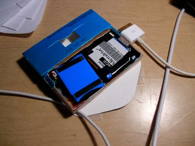

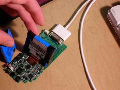

Closer inspection of the iPod mini reveals the two heaviest and bulkiest parts of the machine: the hard drive and the battery. The hard drive (which says "Microdrive" on it) you obviously need to store files. However, the iPod will run without the battery (the other blue square thing) if, and only if, it is connected using a firewire iPod cable. If the iPod you are using is a mini, you can certainly do away with the battery entirely, but you rely on having a firewire connection to every computer you wish to use it on. I recommend that you keep that baby in there.

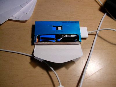

I decided that using a metal case without any inner lining might make unwanted and possibly device-ruining connections on the circuit board. That eliminated a soda can case.

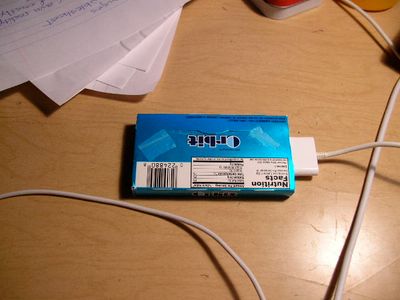

Originally, as you can see in the photos, I used a simple cardboard case scotch taped together to hold the device. It did the trick, but I kept having to cut the scotch tape to show off my handiwork. Too much work.

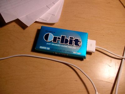

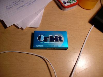

I finally discovered that an Orbit gum case is precisely the right size for a stripped down mini. It's flexible. It opens easily, but can be taped shut to prevent accidental slippage. It even comes in different colors similar to the mini's original casing, and your friends like you even more when you inexplicably give away an entire pack of gum. All in all pretty sweet. Just make sure no one throws it away thinking it's a regular pack of gum. Maybe that's what happened to mine...
