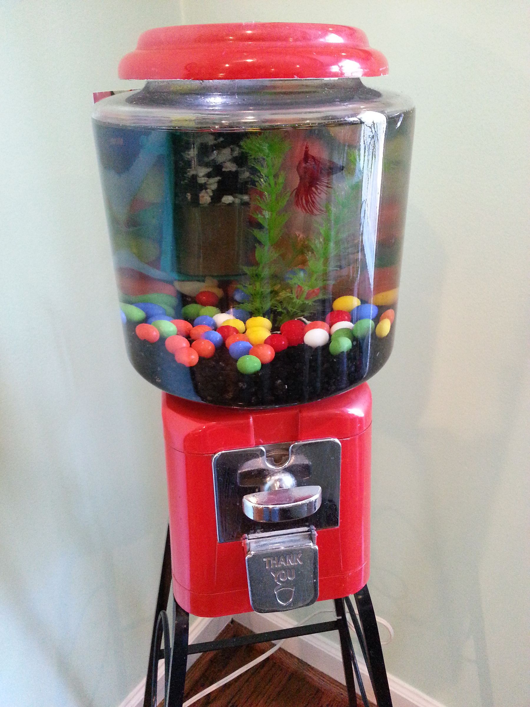

I had the idea to turn an old gumball machine into a small, fun fish bowl. Here's my process.

Step 2: Setting Up Your Base
Drill a hole near the bottom of the base, or where the bottom meets the sides of the case, for your power cord. Then, pick a spot in the back to drill for your light and filter cords. I went a little above dead center. Rubber grommets (~$1.50 from Home Depot) will go in these holes later to prevent wear from the metal.
Arrange your power cord, filter, and light assemblies in the base. This takes some trial and error. I tied all of the loose cable together, and ended up strapping some foam to the bottom of the filter pump to keep it from rattling against the metal. It was helpful that my light's power cable was two pieces, making it only necessary for the holes to be wide enough to pass the connectors, and not the entire light.
I nestled the connectors for the light in the candy chute, to make it easy to turn it on and off without having a cable hanging outside.

Now it's time to water test your globe. Never test it on the base, as if it leaks you'll kill your electronics. I did my first test on the concrete outside, and I'm glad I did. I found a small leak, which I fixed and let it dry again.
Step 8: Setup
Find a nice spot for your aquarium. Rinse your gravel and plants really well before you use them. I used a mix of rainbow and black. It looks terrible. Stick the filter to the inside of the tank, and hook everything up. Condition and add water. Mine holds about 6 liters.
Step 9: All Done!
Add a fish! Bettas are among the few types of fish that will thrive in an unheated tank like this. I chose red to go with the color of the machine, but that's up to you.
I quickly realized how terrible the gravel looked, and switched to all-black. To hide the tube and cord, I printed a gumball background.
EDIT: Later, I decided to spring for about two dozen glass gumballs, and dumped them in the tank for a good gumball look.
