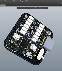

Before getting to the technical details of this gadget, this device will not automatically count the sets but it keeps track of the achieved sets so you need to set manually the sets target and how many sets you did.
The circuit around this design is so simple, two push buttons are needed to increment the counter for the target sets and the done sets, since we are incrementing counters then we need a display tool for these counters and here it comes the role of WS2812B LEDs, I arranged 12 of them in two LEDs bars (6 pixels each) mean the counters will count to 6 for both the target and the achieved ones.
The circuit has been built around Atmega328p MCU but you can use whatever microcontroller of your choice as long as you keep a compact size for your circuit design.

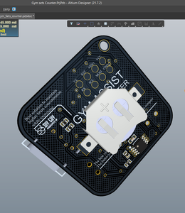

The device will be powered through a Coin cell Battery or Lithium 3.7V rechargeable Battery and for this purpose we will add a charging circuit stage based on TP4056 IC.
I manage to program the MCU using Arduino IDE so I make sure that the Atmega328 that we are using already has Arduino bootloader in it.
Step 2: Circuit Design
Probably the main and most important part of the schematic is the Atmega328PB that I used, it has the smallest package 32 MLF which is important to keep a small size needed for the circuit, I used Octopart to bring all the needed components for the schematic and it is truly handy online tool allowing you to download CAD files of components for several ECAD tools like Altium Designer which is the Designing tool that I used to create both the schematic and the PCB design, you can start your free trial of Altium designer through this link
I also attached the MCU datasheet provided by Microchip, I connected two tactile push buttons to my MCU and used one Digital output to control the 12 WS2812 LEDs, these LEDs are connected in series but it has to be arranged in the PCB layout in two columns (starting from pixel 0 to pixel 5 for first column then from pixel 6 to pixel 11 for second column). I placed a USB C connector to the edge of the design and I will use it for power battery charging.

Before starting any further process let me explain the procedures of the PCB design ordering, any ECAD tool has the ability to generate the design related GERBER file that you will need to place a PCB order, basically all PCB manufacturers require this GERBER to produce your board.
Our design is a 2 layers board design and it has a very compact size of 30 x 30 mm, I moved to JLCPCB where I uploaded my GERBER files and placed a PCB order along side with its stencil.
I used a low temperature profile solder paste to get it work properly for assembly using my Hot-plate. Make sure that you clean your assembled board with some flux removal solvent after finishing the parts soldering.

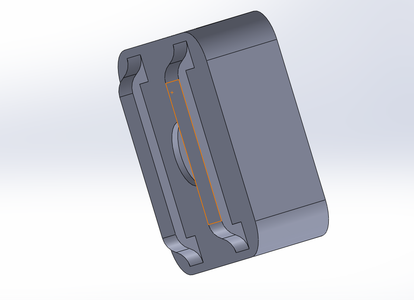

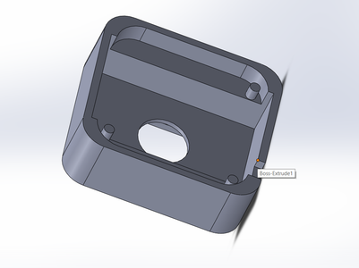

After completing the programming step here I design a small flex housing to make my gadget wearable, I 3D printed the designed housing in Flex material and now the gadget could fit properly to my hand.
