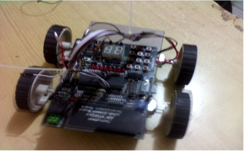

Introduction: Gyro Sensor Controlled Car
Had you ever played games by gyro Sensor on your mobile device ? Of course yes.
You can also use mobile gyro sensor to control any thing(i.e. cars,robots)in real life.you only need few things...

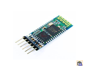

1)A Bluetooth module(HC-05).
2)A Micro controller development board(i am using AVR ATmega16).
3)A 12 volts battery.
4)Four DC geared motors & 4 wheels.
5)A chassis.
6)Some 1-2-1 Connector Wires.
7)A Android/Windows/ios Mobile/Tablet.

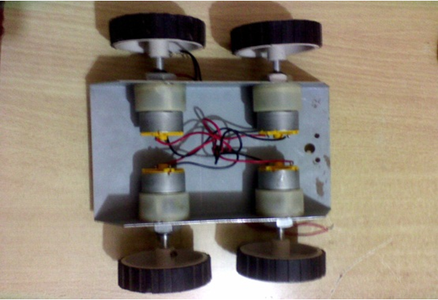

Step 1: Chassis Construction
If you have a car then you can skip this part.
you just need to assemble motors on chassis by bolts.Now mount wheels on motors shaft.your car is ready.

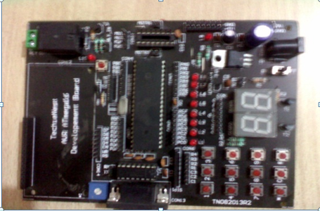

Step 2: Electronics
Now connect bluetooth module to your microcontrollers Rx & Tx pin.Connect motors terminal to motor driver IC.
Now you just need to program your controller and connect to battery.

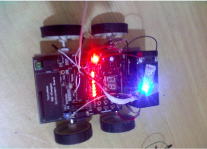

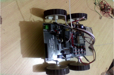

Step 4: Final Step
Now you just need to download a app called Arduino Bluetooth RC Car from play store.
when you tilt your mobile it send data to bluetooth and bluetooth send data to microcontroller.
Turn on power of Car and have fun :)
