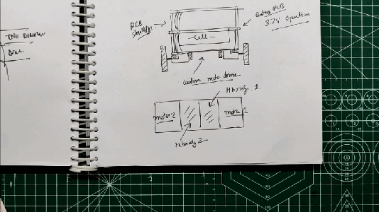

I'm preparing a Small Robot that runs with a 3.7V Li-ion cell which is connected to a boost module that outputs stable 5V for the Motor to run.
But here's the problem: If we increase the voltage through the boost module, the battery backup will decrease, so we have to prepare a 5V Operational DC Motor Driver system.

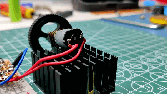

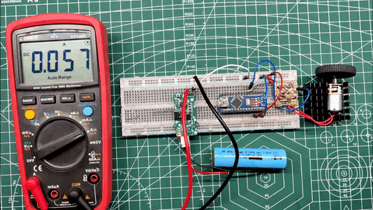

Step 3: Bridge With BC547
So here's a practical version of the above H Bridge Circuit made from Four BC547 NPN transistors and a few resistors. Four 100 Ohms Resistors were connected in Parallel with the VCC side to limit the current flowing through the motor.
This circuit does look janky but it works.

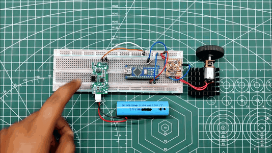

Step 4: Arduino Wiring
As for the Arduino Wiring, we need to connect 5V of Arduino to the VCC of Mosfet PCB, GND to GND, D2 to Base 1, and D3 to Base 2.

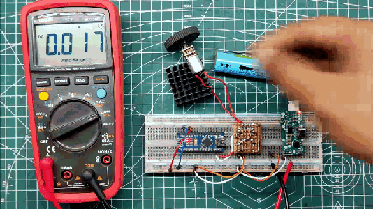

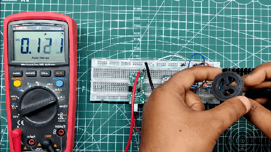

Step 6: RESULT
Here's the Result and as you can see, the motor is working and moving in both directions. It moves in one direction for a second and then changes its direction and then pauses for a moment, this happens in a loop all over again.
We connect a Multimeter in series with the Seeed Module to measure the current consumption of the whole system, idle current is below 60mA but it gets higher up to 140mA if we try to stop the rotation by hand, doing this is like replicating down drag by weight of where this motor will be mounted.
140mA is what we are getting through the BC547 Transistor setup which is really low and not usable for the robot project.
Step 7: POWER SOURCE- SEEED GROVE Module
For powering this setup, I'm using a previously made project which was this SEEED Grove Module.
It's a Power Module that is based around IP5306 Power management IC which boosts 3.7V of Li-ion cell to stable 5V 2A output which is perfect for powering an Arduino Setup with a 5V Motor Load.
This Module was originally made as a Power hat for Raspberry Pi, but in this case, we use it to power this setup.
Seeed Studio Grove System is being used in this Module however because it's not a Sensor board, it's being utilized to add a battery to this module and distribute power through two remaining wires. Two wires are for Battery connection and the other two are for 5V Output and Charging IN.

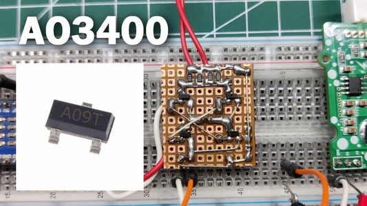

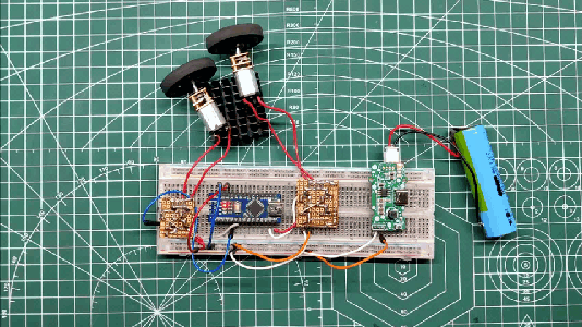

Step 8: H Bridge With AO3400
Next, we try the same setup but with a Mosfet this time, AO3400 N-Channel Mosfet was used to construct an H-Bridge setup by following the above circuit.
This version is better than Transistor H-bridge in many ways, a most prominent one is the higher current output, meaning the motor can draw more current than the previous setup.

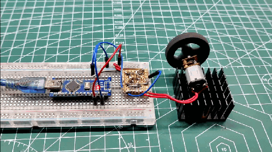

Step 9: Arduino Wiring
As for wiring, we follow the same wiring as done before with the Transistor setup but this time, we add mosfet setup with the Arduino on the same breadboard by putting the VCC of H Bridge to 5V, and GND to GND, gate pins are connected with D11 and D12.

Step 11: RESULT
Here's the result of the Mosfet-based H-Bridge setup that works, this one can flow more current meaning we can drive the same motor with a higher current.
250mA seems to be Max Current taken by the motor at 5V which is plenty for the low-powered mini robot.
Step 12: CONCLUSION AND FURTHER USE
Overall result seems promising and I have already prepared two boards with the above H-Bridge setup, one is the "Minimal H-Bridge" which is similar to the perf board janky setup and the one is a working "Robot Motor driver" that contains two bridges for controlling two motors, this driver will be controlled by an ESP12F Board and I will make a separate article about that so stay tuned for that.
