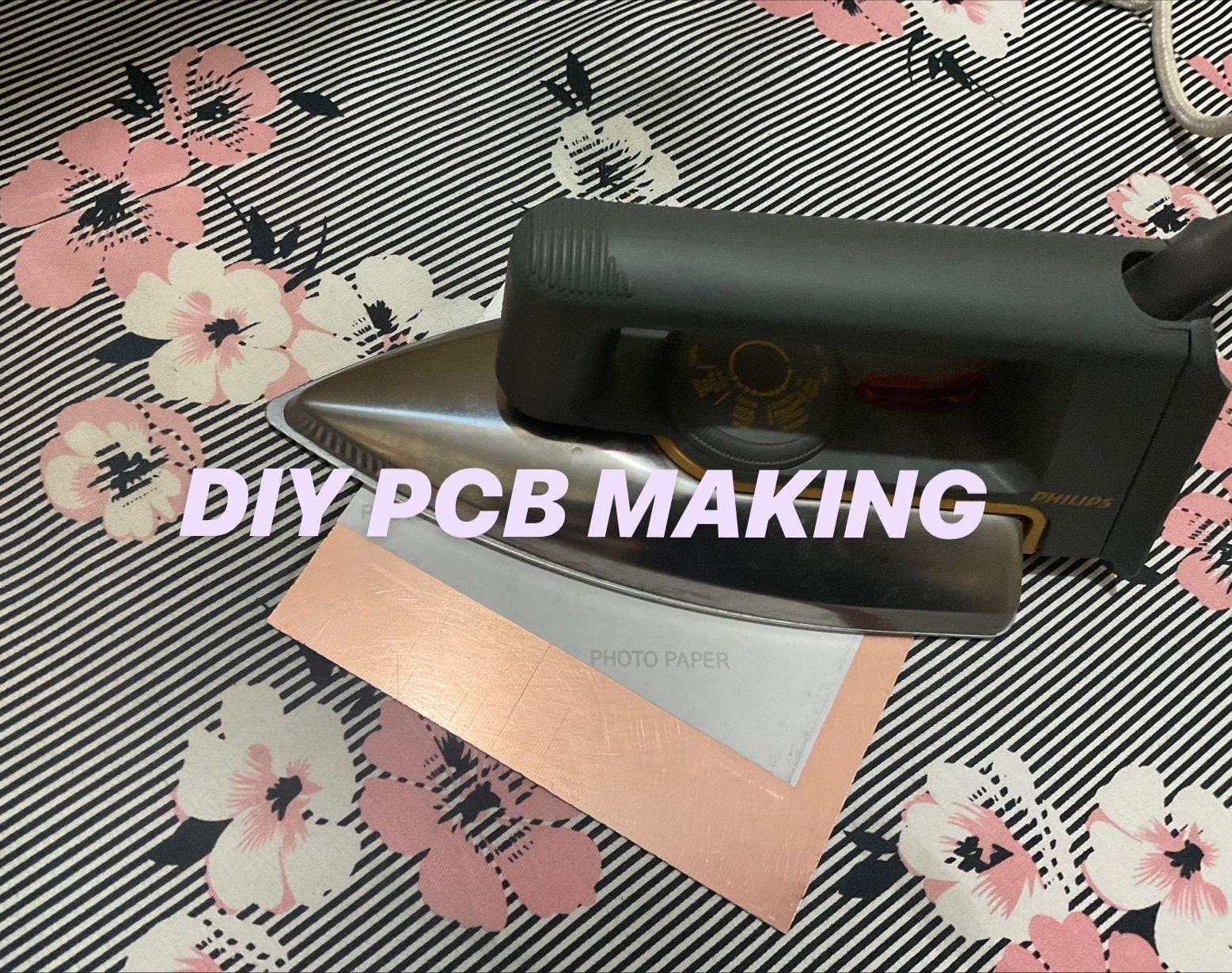

1.3 Prepare for DIY PCB Making
Refer to My DIY PCB Making Instructable.
