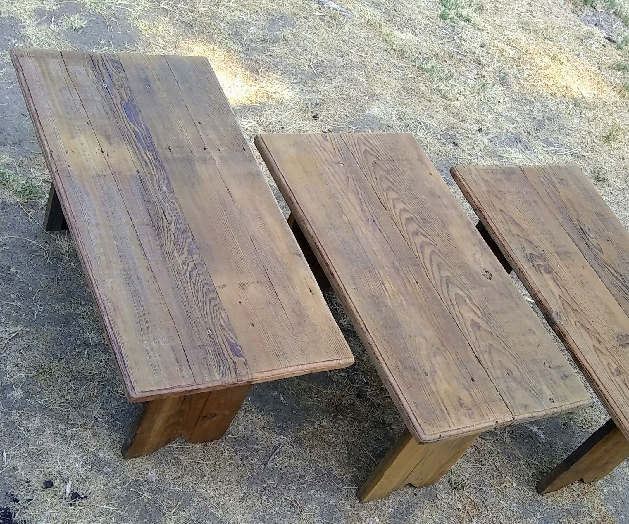

    Hello,
    Thanks for the nice and easy design. With neighbours we had a couple spare pallets and we quickly built a couple shared benches inspired by your design. We used some more planks to stabilize it all as they were rather thin to start with. About 2 1/2 hours to do the first. About 1 1/2 hour to do the second one.
    We will enjoy these through the Summer for sure.
