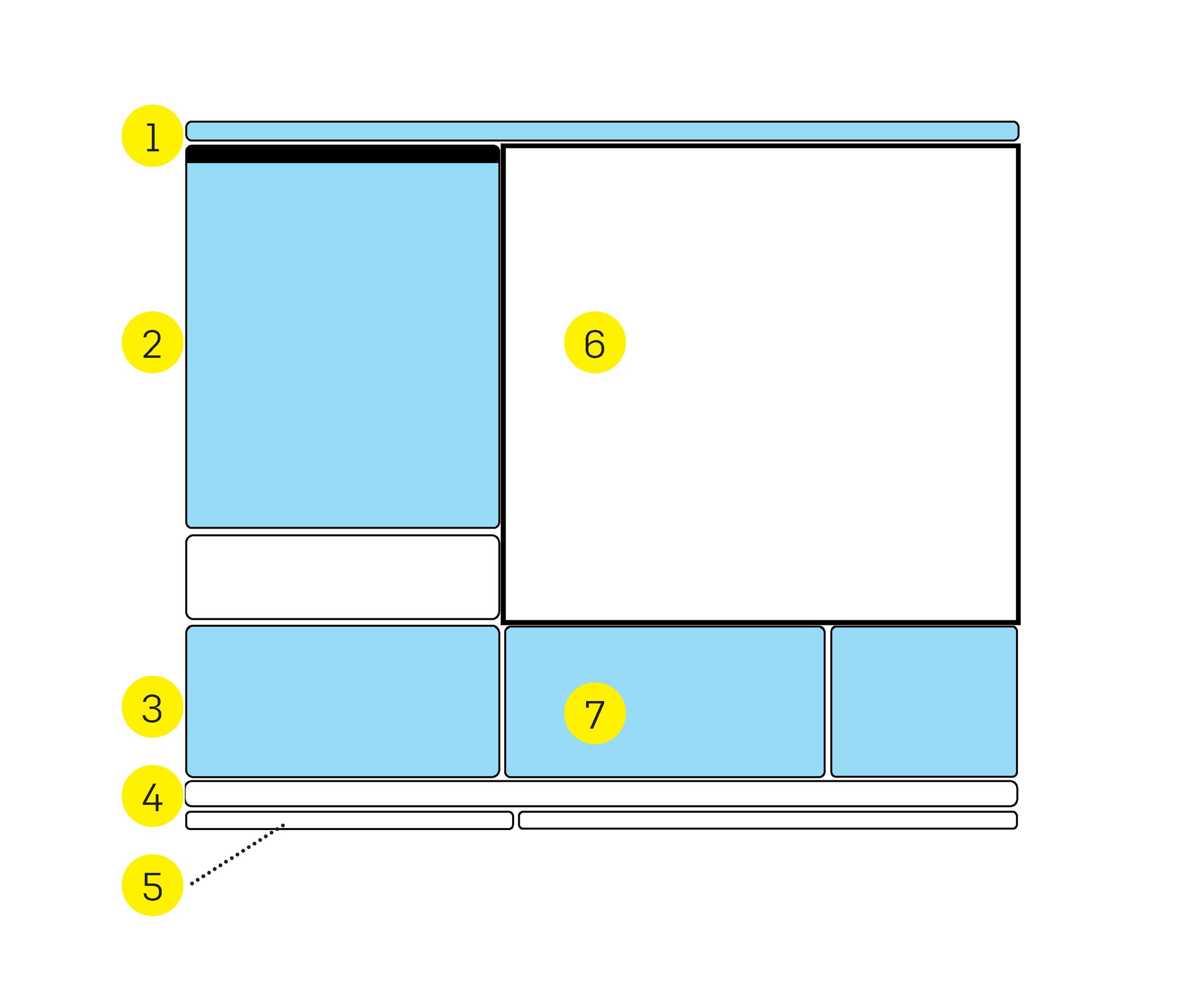

Display
The mill displays information in various areas of the screen. If a screen area is white, it is the active window. Inactive windows are light blue.
The contents of the windows can change, depending on which mode the mill is in. This diagram shows the mill is in operation mode.
- Current mode
- Program display
- Speeds and feeds information
- User messages/Status bar
- Command input
- Main display
- Position display
