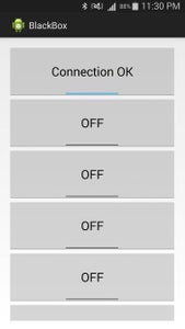

Step 15: Android APP
This app is created by my Brother with out him this project wont be possible always check this step for we have more updates for this for more interesting features.. imagine what you can do with bluetooth and WIFI in the future but since this is his first android app we expect to achieve the WIFI compatible app about a few months later.
There are 8 buttons first is the direct connect button wherein you dont have to scroll down and look for your bluetooth device. and then the 2nd to the 6th is for the 5 relay switches for the last 2 there is the all on and all off button. No i prefer this compared to the voice activation since its kinda weird talking inside your room just to turn something on.

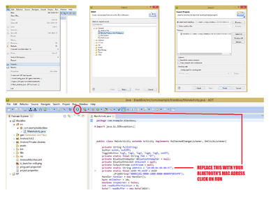

4. FILE->IMPORT->Existing Projects into Workspace then look for the the folder you downloaded ENTER!
4.1. Go to black box -> com.example.blackbox-> src -> MainActivity.java
4.2. Look at the pictures or download tha .rar file and observe the comment on RED saying Replace the mac address.
5.After that connect your android phone enable debugging mode and click the play or run button on the ECLIPSE PROGRAM.
6. YOU should now see the app running on your phone
7. If you do not know the mac address of the bluetooth go to your Bluetooth setting and press the device it should have its address.

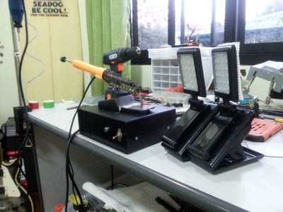

AHHHHHH Finally done. All we have to do is test it with some REAL AC connection.
Get a lamp
A speaker/ amplifier
Fan or what ever you have there .
Plug it at the back of your box and turn it on

4. Testing with our program. Open the app Connect and touch all the buttons all of it should have a switching sound.

Hmmm a tricky part here well since I love electronics, playing video games and technically doing most of my thing on my computer table part work station I would put it there. But I guess if your use is only for the bedroom then I guess near the bed. If you love watching movies etc then obviously near the TV.
Now that I have this blackbox I would connect it to some of my handy tools like the soldering iron,LAMPS,FAN,Guitar amp and dremel tool and maybe the computer but then I need to do some more wiring to make the switch for the computer but anyways it should work out fine.
