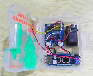

Step 5: Power Box
The battery voltage of my scooter is 40V, which is too high for the Arduino and sensor modules.
So I use a 40V to 5V power supply module to generate 5V, I try to use this module directly to the supply the system. I found that is not stable, often reset, I suspect that the scooter is running the process of voltage instability caused.
So I have to change a way. I made a power supply box, which contains lithium batteries, lithium battery management module and 40V to 5V power supply module. The use of lithium battery to the supply the system power, and through the 40V to 5V voltage generated by the lithium battery to charge. Although it looks a bit complicated, but this is a good solution to the problem of power supply instability.
About the connection diagram you can refer to the picture of the attachment.
