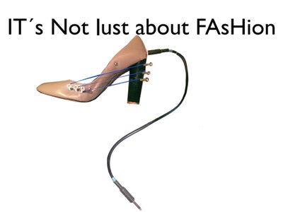

Step 1: Materials You'll Need to Build a High Heeled Shoe Guitar
1 High Heeled Shoe (i bought mine from Zara as i wanted to make a statement against fast fashion and give a women's stiletto a new empowered feminist meaning contra to the notion of the fetishistic High Heeled Shoes they sell too many of and that cripple women's feet after long term wearing).
6 screws, diameter 2.5mm each for guitar strings, you will need to cut groves into the screws using a hack saw
2 extra screws 2mm each
3 electric Guitar Strings (they cannot be bass strings as they don't work) for electric or acoustic guitar, with plain steel ball end, .017" diameter .432mm ( i use these strings: ghsstrings/battlecreek/michigan/usa)
1 Pick up (a pickup is a transducer that captures mechanical vibrations from stringed instruments)
1 Stereo Guitar Lead (as thin as possible, so its not too bulky inside the shoe)
1 Stereo Jack input

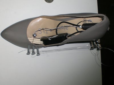

1 small piece of wood (1cm x 1cm x 2cm) for reinforcing the left hand big toe of the shoe (as in photo) as there is a lot of tension due to the strings pulling the heel and toe of the shoe, so you'll need some internal support elements.

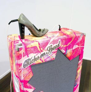

This is the AMP i designed, it was screen printed by Johnny Dog day and Melissa Logan in Berlin, the hard building work was done by Gianluca Turini who made it at his company lab: MAGNITUDE AMPS in Bologna Italy, January, 2015. As it's sometimes tricky to bring loads of guitar pedels, Gianluca and I thought it'd be a good idea to have different effects built into the AMP, so there's 15 different effects possible, which is amazing to perform with live, as it gives you a really instant, flexible and varying dynamic sound at the turning of the dial on the top of the amp. The special secret functionality is a built in theremin, see the white Arial on the top right of the AMP.
