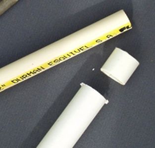

Step 2: CUT THE PIPE
There are two kinds of pipe used here. 1/2 inch PVC pipe is common plumbing pipe. CPVC pipe is similar but chemically a little different. It is used for hot water plumbing. For some reason, 1/2 inch PVC pipe refers to the inside diameter of the hole. 1/2 inch CPVC pipe refers to the outside diameter of the pipe.
There are some variations in the wall thickness of the PVC pipe. I use the thicker-walled pipe to make the end rings. They make a tight pressure fit over the CPVC pipe. Thin-walled PVC pipe fits too loosely for the purpose it serves in this project.
The grape boxes come in different widths sometimes. Measure and cut two pieces of the smaller diameter CPVC pipe. They should be long enough to stick out about 1 1/2 inches, or 2 inches on either side of the box.
Cut four sections of the 1/2 inch PVC that are about 3/4 inch long. These are the end rings that increase the outside diameter of the CPVC sections, thus preventing the wire used for hanging the planter from sliding off the end of the pipe.
Since you have to trim the inside of one end of the rings, and holding small objects can be dangerous while trimming them with a knife, I do the trimming of each ring before cutting it off the end of the pipe with the saw. Trim-cut, trim-cut, trim-cut, trim-cut. (See the diagram in Step 4.)
