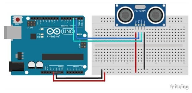

Step 1: Connections
Connect the pins of the ultrasonic sensor as shown in the image. (Credit: MakerGuides.com)
VCC > 5v
Trig > digital 2
Echo > digital 3
GND > gnd

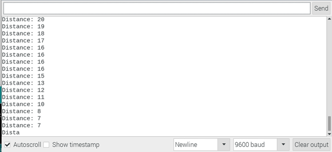

Step 3: Test and Results
Open the code and upload it to your Arduino board. Open the serial monitor and view the results. Place an object in front of the sensor. I have found this code to be accurate from 0-2 cm (0-1 in.). In your program you can easily call:
getUltrasonicDistance()
to get the sensor reading. Happy coding!
