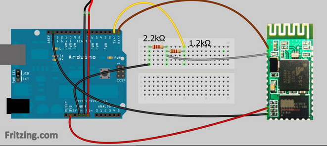

Recently I borrowed a Bluetooth module from my friend, because I had misplaced mine. I noticed that the Bluetooth module had no breakout board. So I read though the data sheets and found that this was a HC05 and it ran on 3.3v logic. But the Arduino TX pin runs on 5v signal, so all you needed to do is build a breakout board for it here is how you do that.

Step 2: Circuit
The circuit is quite simple all you have to do is create a voltage divider using a resistor combination the required output is 3.3v. Assemble he circuit on a pref-board. Try out some test sketches in the examples section of the Arduino IDE to make sure you got it working.
