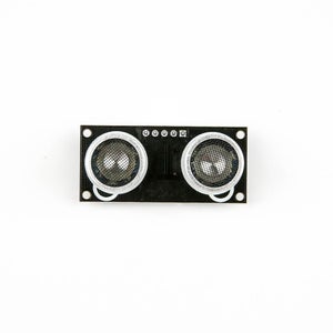

The HC-SR04 5V Ultrasonic Sensor is one of the most popular robotic sensors used to measure distance in DIY applications for Raspberry Pi and Arduino. It is very easy to use and has just 4 pins.

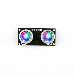

I found this new version of the sensor online that is essentially the same thing, except it has an RGB input that allows for a beautiful display of colors within the transmitter and receiver cylinders, containing a total of 6 LEDs (3 per cylinder). This is essentially the same sensor as the RUS-04 (which you can find with a google search).
Using the ultrasonic module was super easy as there are many examples online of how to use it with MicroPython and the Pico W because it works the same as the regular HC-SR04. However, in terms of the RGB module, it took me some digging to figure it out because nobody has used this sensor in MicroPython given that it is relatively new.
After some research, I realized that the only example of this sensor online was this gentleman who demonstrated how to use it with Arduino... but I needed it for MicroPython. I eventually found out it followed the WS2812 lighting standard so I eventually found a library I slightly modified for the Pico W which I link here:
Github Link For NeoPixel Library for Raspberry Pi Pico W

For this, you do not need the trigger or echo pins to set up it just randomly changes the colors of any of the 6 LEDs onboard the device, so it can make for some fun colors to look at.
Also, this helps you get a better idea of how the lights are triggered. You just need to set the LED of your choice with an RGB value and that is the premise of how the whole thing works at a high level. I demonstrate this above in the photos, you can see the random assortment of colors. I only used 6 for this demonstration but you can play around with RGB values!
