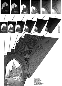

With HDR photography we often use a tripod or otherwise mount the camera securely in the environment. Likewise with surveillance video the camera is often affixed to a building. But with wearable cameras the camera is moving around, as part of an EyeTap or other Digital Eye Glass, for example. In this case, our alignment problem is a problem in spatial as well as tonal registration. The comparagram gives us the tonal alignment, but more generally we also need spatial alignment, e.g. as is done in panoramic imaging, http://wearcam.org/orbits/ Here is a research paper on that topic: http://www.eyetap.org/papers/docs/icip1996.pdf
Orbits are 360-degree maps such as spherical or other projections, that allow the eyeglass wearer to look around and see things from every angle.
Start simple: try an example with just two images.
Different exposures can arise naturally with automatic gain control (AGC) or automatic exposure, e.g. when you point a camera at something really bright like a light source, or, in the example above, an open doorway to a bright outdoor scene, the camera will "dim down" revealing highlight detail. As you swing the camera away from the light source (e.g. to the right in the example above), the camera will "brighten up", revealing shadow detail.
It is in the areas of overlap where interesting things happen. Here we get differently exposed images of the same subject matter, as the camera moves around.
Step 4: Combine the Aligned Images
An important result in comparametric image analysis is being able to "stitch together" multiple images of the same scene to make sense of the world.
Once you have images that are aligned, you essentially have multiple measurements of the same quantity.
Think of it like a voltmeter where you measure voltages on the different settings of the meter, and then you want to combine them all together into a single reading, at each pixel.
Its kind of like voting, where each image gets to "vote" on what a pixel value should be at a particular location. But not all votes are equal. In the dark areas, we want the brighter images to have a stronger vote because they have a better rendition of those areas. In the darker areas we want to brighter images to have a stronger vote. In the midtones, we want the medium exposures to get the strongest vote but still have a good contribution from the light and dark images.
So we have a weighted sum, as indicated in the formula above. See http://wearcam.org/comparam.pdf
