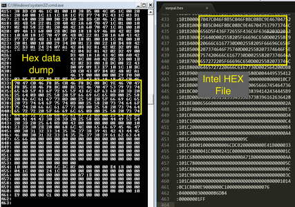

Step 1: Intel Hexfile to an Array Based on Data Address
To load data from an Intel HEX format file I used several functions, open_file() to create a data stream, more commonly know as a file pointer, from the file I wanted to read. And hex_file_to_array(), to parse the hex file and extract the data.

Step 3: HEX File Format
Let's take a look at the raw data,
:10010000214601360121470136007EFE09D2190140
:100110002146017E17C20001FF5F16002148011928
:10012000194E79234623965778239EDA3F01B2CAA7
:100130003F0156702B5E712B722B732146013421C7
:00000001FF
Parsed HEX file:
: 11 2222 33 44444444444444444444444444444444 55 \n

Step 10: Hex_File_to_Array()
Code Link
  • 23: We count the number of lines in the file we wish to extract data.
  • 31: This is the work-horse loop. We loop until the we have read through all the lines we counted.
  • 33: We pass read_line_from_hex() our variables we wish to fill. The hex file we want to parse (file), the buffer we hold the line data in, the int array which will serve to hold the address of this line of data, a variable to hold the number of bytes in this line. If the function was got data, it will return true. Otherwise, it will return false. We store this flag to make sure we got something.
  • 34: We check to see if we actually got data from our attempt.
  • 39: Here, we move the line of data from the buffer into the final array.
  • 41: We place the data into the array based upon the address we pulled from the line (address1 + address2) and the byte number.
  • 42: Reset the buffer to nil.
  • 49-64: Finally, we print out the data. The k-loop goes through each line we extracted; the j-loop goes through each byte found on the respective line.
And that's it. Note, 49-64 is meant to demonstrate the data is properly extracted. These lines could be moved to another function where the data may be used as needed.
