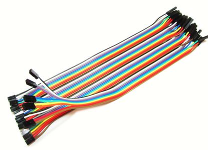

4. Jumperwire  (male to male 10 pice) (male to female 5 pice) (female to female 5 pice)

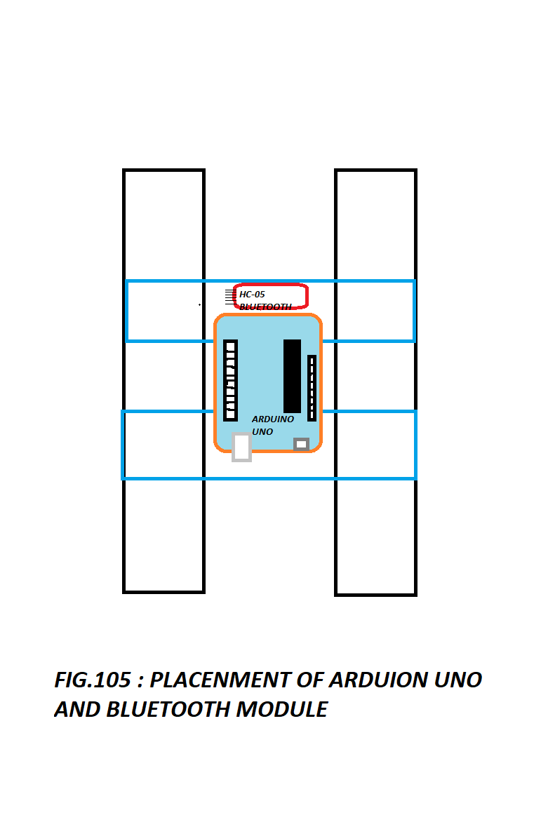

Step 2: BODY PARTS
THE BODY PART CONSIST OF 6 LEGS WITH 6 LIMBS IN UPPER BODY PART 16 CM RULER IS PLACED IN PARALLEL AND ATTACH
HORIZONTALLY WITH 2 ,9CM RULER .
FOR THE LEG I CUT THE RULER OF 10 CM LONG WHICH HAS SAPE UPPER PART BIG AND COMMING DOWN THIN.AS WE HAVE 18 SERVO MOTOR,WE NEED 18 OUTPUT PIN IN ARDUINO. DUE TO NOT USING OF ANY MULTIPLEXER IC'SIN MAKING THIS ROBOT ,AVAIABLE OF DIGITAL PIN IN ARDUINO UNO IS ONLY 12. SO,I CAME TO A SOLUTION OF MAKING COMMON SERVOS OF LEGS.AS: SERVO 2&3 ARE COMMON IN WIRING, SIMILSRLY 5&6, 8&9, 11&12, 14&15, 17&18

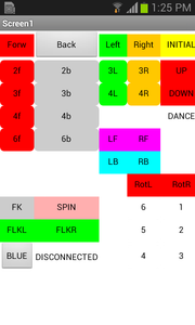

AND ALL THE COMMAND TO THE SERVO MOTOR ARE SEND FROM MOBILE THROUGH BLUETOOTH MODULE VIA TX AND RX PIN IN ARDUINO. COMMON SERVOS GETS SAME SIGNAL AT A SAME TIME AND RESPONSE AT SAME TIME. BY WHICH THE MOVEMENT OF THIS ROBOT FOLLOW THE TRIANGLE MOVES FIRST LEGS WITH SERVOS (1,2,3) (13,14,15) AND (7,8,9) AND THEN AFTER SOME DELAY ANOTHER PART OF BODY WHICH CONSIST LEGS WIH SERVOS (16,17,18) (4,5,6) (10,11,12) MOVES.
Step 4: MOVEMENTS: AND PICTURES
I HAVE GIVEN   FORWARD ,ROTATE  COMMAND.

Step 6: PROGRAMMING ARDUINO AND ANDROID APK

Step 7: MOBILE APPLICATION
AS SHOWN IN THE PICTURE THIS IS THE MOBILE APPLICATION SCREEN .THER IS A CONNECT BUTTON IN THE APPLICATION, WE HAVE TO CONNECT OUR MOBILE WITH ROBOT VIA BLUETOOTH .WE WE GET CONNECTED .AS WE CLICK TO ANY BUTTON IN THE SCREEN THE MOBILE SEND THE RESPECTIVE COMMAND AND ROBOT SHOWS MOVEMENTS. IF WE CLICK THE FORWARD BUTTON THE ROBOT GETS FORWARDS 1 STEPS ,THER'S BUTTON FORWARD , 2 FORWARD ,3 FORWARD ,4 FORWARD ,5 FORWARD THESE ALL BUTTON GIVES FORWARD COMMAND WITH N TIMESMOVEMENTS WHERE N IS THE NUMDER BEFOR FORWARD IN BUTTON .SIMILARLY BACKWARD HAS ALSO SAME PRINCIPLE.
THERE A INITIAL BUTTON WHEN WE CLICK ON IT ALL SERVOES GOES TO INITIAL DEFAULT POSITION 90 DEGREE AND ROBOT GETS STAND STILL .OTHER BUTTONS LIKE UP GIVE COMMAND TO ROBOT TO GET UP IN 4 LES AND DOWN BUTTON GIVES COMMAND TO LOWER THE BODY TO THE BASE .
SIMILARLY RIGHT AND LEFT BUTTON GIVES COMMAND FOR TO ROTATE RIGHT ANND LEFT RESPECTIVELY. ON THE RIGHT DOWN BUTTON 1,2,3,4,5,6, GIVES THE COMMAND TO ROBOT TO MOVE THE LES INDIVIDUALLY.
TO MAKE THIS ROBOT MOVEABLE WE CAN USE DIRECTLY 5VDC THROUGH OUR MOBILE PHONE CHARGER ADAPOTR OR WE CAN USE POWER BANK AS PORTABLE SOURE . I FELL LOTS OF FUN TO MAKE ROBOT AND TEST IT .ITS SIMPLE TO MAKE AND TEST IT .
THANK YOU IF YOU HAVE ANY FEEDBACK AND SUGGESTION ,PLEASE LEAVE IN A COMMENT ... I HOPE YOU ALSO TRY IT .
