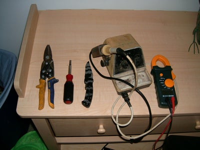

Tools:
knife or strippers
soddering iron(not essential but saves time)
screw driver
voltage tester(depends)
*drill
*#7 bit
*1/4" tap
*may change depending on the electrode you use and how you connect it to the wire

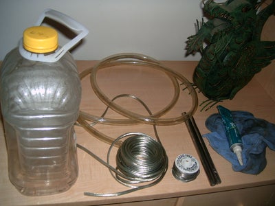

Materials:(Keep in mind all the materials I used are "borrowed" from work or I had around the house so they won't be the most effective solutions. Be creative with what you use)
Plastic container (I used a grape juice bottle)
High temperature silicone sealant <-expensive; regular silicone sealant MAY work
Wire (I used some left over wire from the amp that went in my wife's car, 14awg)
Teflon tape
Plastic tubing (I had to siphon gas once to change the fuel pump and had this hose from it, not sure why I kept it but I'm glad I did)
salt (for an electrolyte in the water)
Stainless Steel Electrode(update: THIS WILL NOT WORK)

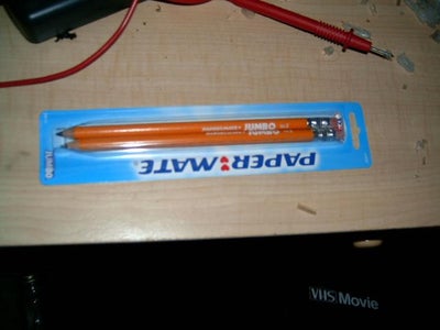

-I ended up using the graphite from 2 pencils as my electrodes

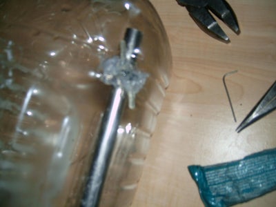

Step 3: Building Your Electrodes
I originaly intended to sodder my wire to the stainless steel. Go ahead and try if you like but it wont stick. So then I decided to drill and tap a hole in the pipe. I feel a clamp on connector would work better but I didn't have one. I did have a 1/4" bolt though. Wrap one wire around the bolt and screw it in tight. The bolt I used was very short and did not go through to the inside of the opposite side of the pipe. The screw in method I used probably saves more space than a clamp on.

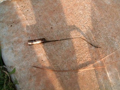

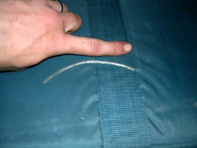

-Ok, so apparently regualr stainless steel does not work as an electrode. It lasted for 8 operational hours. People have said that 316L stainless will work better but I have my doubts. Instead I made them out of graphite. I give complete credit to hooloovoo33 for the suggestion in his instructable here( https://www.instructables.com/id/Separate-Hydrogen-and-Oxygen-from-Water-Through-El/ ). It is a very long and tedious prcoess the way I did it. I bought 2 jumbo sized kid's pencils(78 cents) and carved them down to the graphite core. I originally thought "I will just carve down one side and lift it out of the wood". WRONG. Pencil companys must use glue in their process becuase it dosnt come out easy. Even thin solitary pieces of wood clung to the graphite. What you can do is type in to google "buy graphite rod" and the machine shops that sell it will pop up(along with fishing poles). I found it as cheap as $5.86 for a single 1/2" by 10" rod, which would be enough when cut in half.
To connect the wire to the pencil lead I stripped back a long section of wire wrapped it around the lead twice and then twisted the wire back on itself and twisted like crazy with pliers. At this point I broke open the tube of sealant and dipped the end of the grapite with the wire in sealant. It gave me a great seal doing it that way rather than going over and over it with the tube's end. This was more a matter of frustration than technique. You need two conductors so do this twice.
After it dried I wrapped a big thick tye wrap around the top and bottom of each piece of graphite. Then wrap another tye wrap to hold them together. They should still be the width of a thick tye wrap apart. This is to allow the electrodes to be as close as possible without touching.

Step 4: Inserting Your Electrodes

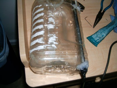

I did this all wrong at first. I was cutting holes in the plastic with my knife. It is so much better to use a soddering iron to melt a hole in your grape juice bottle and then using a circular motion widden it it to fit your electrode. I had to seal over and over again on the knife cuts but the soddering holes sealed in one try.
Now you ask where do I put these holes at? I placed my electrodes on opposite sides of the container. I was thinking that the further apart they were the more water the current would pass through and create more HHO. I later read that having them closer together is actually more preferable as the electricity is "burned up" in the resistance rather than actually doing work on seperating the molecules. Please post if you think you know how it really works.(update: not necessary. Put them very close together)
However it works, it is very important to know that the electrodes are NOT continuous. That means they do not touch anywhere and they need to be secured so that while driving they do not run into each other. To secure my electrodes I soddered two holes next to it while it was in the container and fed some wire sheathing through to tie it down. It is likley this step will frustrate you unless you plan on big holes and more sealant. I would not recomend using any sort of metal(tie wire)because it will corrode inside the container. A tie wrap would probably be nice though.
The wire and connector on the electrode need to be on the outside of the container. Then you can begin the sealing. Generously apply sealant to anywhere water may leakout. Let it dry for 24 hours(so says the tube) then fill it with water. If it leaks drain it and put more sealant where it was leaking.
Advice from a big dummy: If your electrode is hollow like mine seal one or both ends. I will let you think why.(there's 24 hours wasted)

-the graphite I used is much much smaller than the original electrodes but produces almost the same ammount of gas because they are so close. Holding the graphite down inside the container isn't as necessary because the tye wraps will always hold them a certain distance apart.

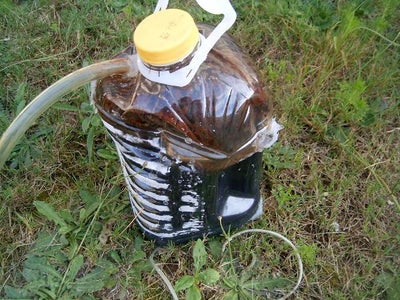

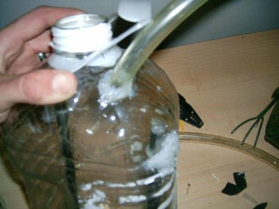

Step 5: From Container to Car

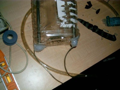

Now do the same for your plastic hosing as you did for the electrodes. Melt(or cut) a hole IN THE TOP and seal your hose into it. The hose needs to be long enough to reach the outlet coming from your air filter in your car. Melt(or cut) a hole in the hose leaving your air filter and seal in the hose coming from your HHO container. Ouch, I hated to do that step. Willful destruction of car parts. It helps a lot if you have an easily removable piece like I did.
I wanted to mention it somewhere and I thought the inserting your electrodes step was already to long, wrap some teflon tape around the teeth that hold the cap on. This will cause LESS HHO to leak out the top. I don't think its possible to completly stop hydrogen from leaking out of a container while allowing easy access to pour more water in.
The water you put in this container needs to have baking soda mixed in. I read that using salt will produce chlorine gas. That seems likley to me as salt is NA CL. Sodium and chloride on their own are deadly to you but combined they sure taste good. In other words don't use it.

-I was going to use baking soda origianly but I later read that it lets out solutions that are corossive to aluminum. Chances are your car's engine is made out of it. Furthermore, the chlorine will be coming out of your tail pipe. Who breathes in car emissions that wants to live anyway? The chlorine released is small ammounts too.
