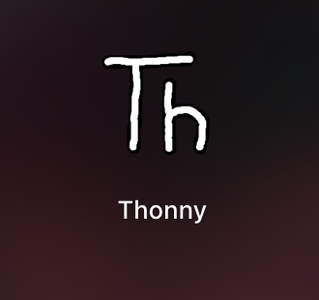

Step 2: Software Configuration:
Install the necessary libraries for I2C and the VL53L0X sensor. Use micropython-i2c-lcd for the display and a compatible library for the sensor.
Configure the Raspberry Pi Pico to use the GPIO pins as per the schematic. Download the main.py executor in thonny, remember to have the board configured in the rapsberry pi pico interpreter
