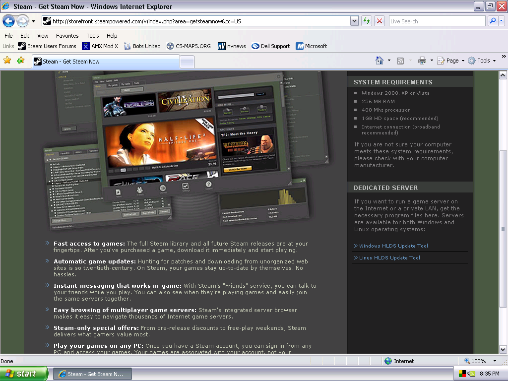

Step 2: Now Go Get HLDSUpdaterTool
Go to Steam's web site and follow the pictures or click to direct link:
Steam Powered
Direct Download Link
Save the file to your desktop.
Steam Powered
