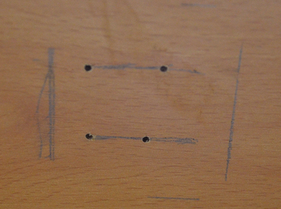

- Draw a holes: draw holes from sliding profile on underlay (wood / wall) (pic. 3)
- Drill holes on border and in half of 2 holes inside of sliding profile acc. (pic.3-4)
- Screwed to underlayer (wood / wall) (pic. 4)
