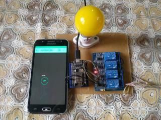

Step 4: CIRCUIT DIAGRAM
First take the power lines onto the bread board from microcontroller
VCC/5v-->+ line and GND--> - line.
Then connect the relay module to the power lines on bread and also to 220/110V AC supply as shown in above diagram.
Now connect SIGNAL PIN OF RELAY MODULE TO ESP8266 PIN
Now connect Ac bulb in series with relay module AC supply as shown above.

Step 6: WORKING
As the code starts it initializes the pin to which the relay module is connected and then waits for the data received through Wi-Fi.
After it receives the value it then turn on or off the bulb according to the value received through blynk app.
