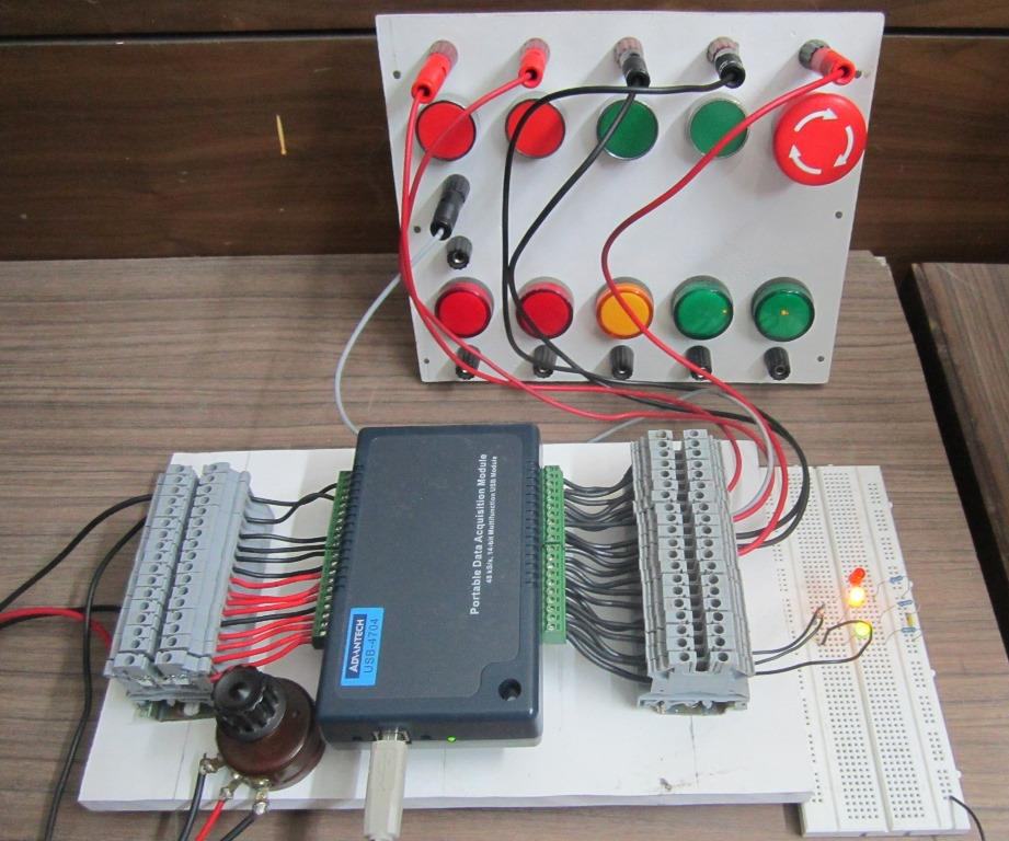

Step 1: Wiring Diagram With USB 4704 DAQ Card I/O Solutions:
Input Wiring:
We have connected Potentiometer 5 Kilo Ohm to the Analog Input of DAQ Card as shown. Terminal at left & right end are connected to 5 VDC & Analog Ground of DAQ Card.
The middle terminal of Potentiometer is connected to AI0 of DAQ Card. When we rotate the Potentiometer, we got 0 ~ 5VDC from Potentiometer which goes to DAQ Card and gets converted to Digital value 0.00 ~ 5.00 (Floating Value)
Output Wiring:
We have connected the Multimeter to read the Analog Output from the DAQ Card. The RED lead is connected to AO0 & Black Lead to Analog Ground of DAQ Card.
We are using Multimeter to read the feedback of Analog Sensor in Home I/O

The potentiometer connected at AI0 given 0 ~ 5VDC based on its position. We have connected a Float Output with address ‘0’ which is getting the Digital value in the range 0.00 ~ 5.00.
Multiplication Factor of 2
Now, we know that the Analog Output in the Home I/0 behaves in the range 0 ~ 10 & our DAQ Card range is 0 ~ 5. So we have multiply the value of AI0 with factor ‘2’ & has given the output to Light (Type Analog) to Porche 1 (Bit 158), Porche 2 (Bit 159) & Pool (Bit 160).
Step 6: To Read the Feedback of Brightness Sensor in Multimeter:
The Brightness Sensor Bit 139 respond to the Luminance of Day light such that when Luminance is 0%, Floating Value is 0 & When Luminance is 100%, floating value is 8.
We have read its value & scale it to the range from 0 ~ 8 to 0 ~ 5 VDC by multiplying it with the factor of 0.62. We are doing the scaling because the DAQ card can give output in the range of 0 to 5 VDC only.
Calculation of Multiplication Factor: 8/5 = 0.62
