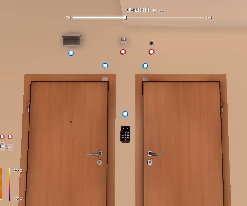

Starting Conditions: Home I/O is being controlled by Inbuilt Sensors
I/O Signals
Inputs:
- Door Detector 1 (Bit 78)
- Door Detector 2 (Bit 79)
- Motion Detector (Bit 258)
- Alarm Keypad- Armed (Bit 82)
Output: Siren (Bit 58)

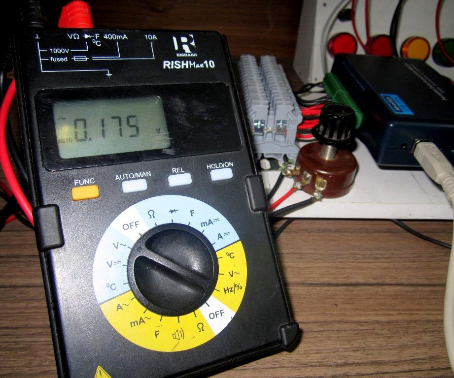

Step 2: Wiring Diagram With USB 4704 DAQ Card I/O Solutions:
Input Wiring:
We have connected Push Button NO & NC to the Digital Input of DAQ Card as shown below. IN0 is Normally closed switch, such that, it TURN ON the DI0 if not pressed, on being pressed it TURN OFF DI0. Whereas IN1 is push button Normally Open, which TURN ON DI1 when pressed, else it DI1 is OFF.
Output Wiring:
DI Output are configured to give LOW signal (O VDC) when Turned ON. In DI0 ~ DI2 we have connected LED’s with Series resistance (220 Ohm). When signal at DI0 ~ DI3 goes high, the respective LED goes ON. The Positive side of LED is given 5VDC from the DAQ Card.
