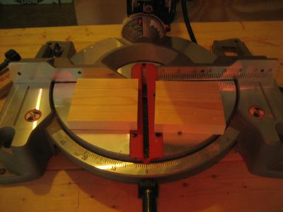

Making the frame for the easel called for joining the scraps I used to make them longer. Of course, this entire easel can be built with full dimensional lumber purchased for the project. But this HOW TO was a challenge to not spend a cent.
Step 28:
Each piece was glued, screw and laid against a straight edge.

Now to build the frame. These are the frame cross braces ripped from the scrap 2 x 4s to 1/2" thick and cut to 18" long.
