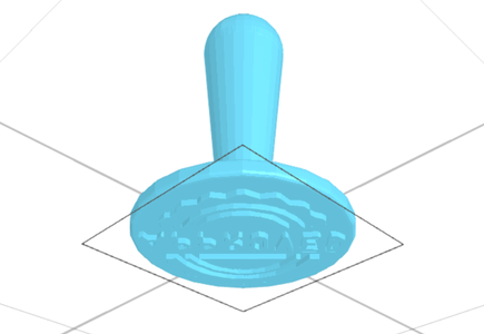

Step 1: Insert a Image to Convert It to 3D and Scale It
First of all, select the image to 3D and insert an image similar to the image shown in reference. Set resolution to 250, tolerance to 0.1, amount to 4, flip background to true and simplify to true. Then select the scale tool and set keep proportions to true and y to 30.
Step 2: Rotate the Object and Move It
Next, select the rotate tool and set x to 90. Then select the move tool and set y to 0. After that, opt for polygon selection and select the faces as shown in the image.
Step 3: Fillet the Edges and Insert a Cylinder
Now, click on to edge select and from modify category select the fillet tool. Set intensity to 0.1 and level to 3. Then from the 3D shapes insert a cylinder. Set top radius to 19, bottom radius to 19, height to 3 and position y to 1.
Step 4: Fillet the Circular Edges
Next, click on the advanced settings button to change the selection settings. Set loop selection to true and select both the circular edges of the object. Then fillet them to an intensity of 1 and level of 4.
Step 5: Insert Another Cylinder and a Sphere
Now, we will insert another cylinder and set top radius to 8, bottom radius to 4, height to 40 and position y to 4. Then insert a sphere and set its radius to 8 and position y to 36.
Step 6: Make All the Objects a Union
Next, from the edit menu select all objects, go to stitch and scoop and make them a union.
