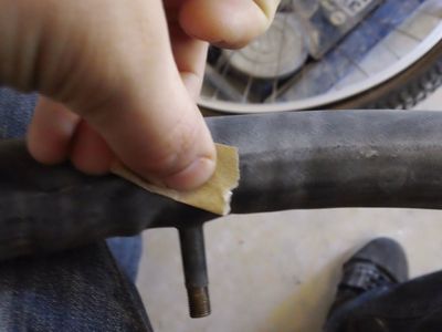

Step 5: Step 3: Sand the Area Where You Will Be Putting the Patch.
You will need to sand all the bumps out and it will give the rubber cement something to grab onto.
