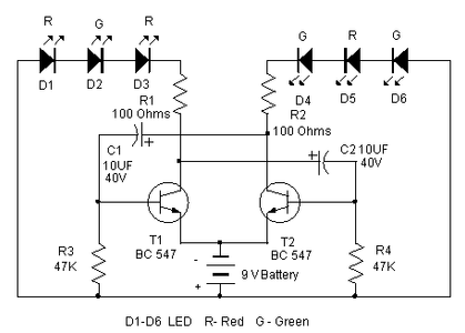

It works on the principle of charging and discharging of capacitors C1 and C2. Current from the positive of battery flows through first set of LEDs D1-D3 to the collector of Transistor1 through resistor R1. Resistor R1 limits current through the LEDs to protect them. The current through R1 charges capacitor C2. It then discharges through the base of T2 and resistor R4. This gives base current to T2 and it conducts. As a result second set of LEDs D4-D6 lights as the current flows through T1.Capacitor C2 again charges and the cycle repeats.
***********In the schematic the led's are of particular colour but i used them of different colours,so that it looks good**********

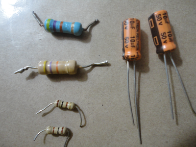

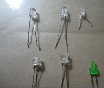

1. LED'S (of any colours according to you)
2. BC547 transistors X 2 (BUY)
3. 100 ohm resistors X 2 (BROWN BLACK BROWN) (BUY)
4. 10 micro F 40Volt capacitor X 2 (BUY)
5.47K ohm resistor X 2 ( YELLOW VIOLET ORANGE) (BUY) SEE - Calculating resistance value

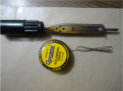

1. Soldering iron
2. Solder wire

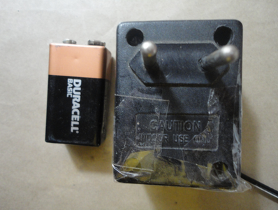

5. 9 VOLT BATTERY

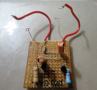

Step 4: ASSEBLING THE PARTS

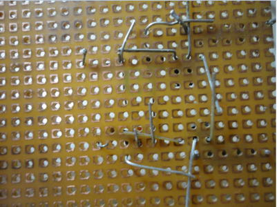

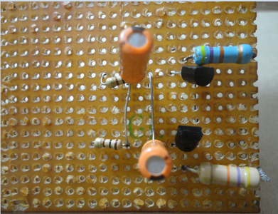

First of all arrange all the parts on the PCB according to the schematic.Be carefull for the capacitorsas they may explode if connected in reverse polarity.
Then join all the parts .Then just solder them all together.

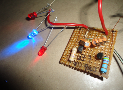

Now just turn off the lights and you are ready to party.
enjoy!!!!!!
Well I wolud like to tell you one thing that you may create difference in the blinking of the LED's by replacing the capacitor from 10uF to 100uF.

Step 5: THE CAPACITOR

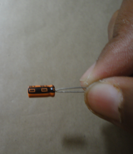

I would like inform you in advance that an electrolytic capacitor has to be correctly positioned according to its polarity or it may explode.!!!!!!!
