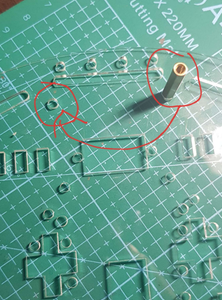

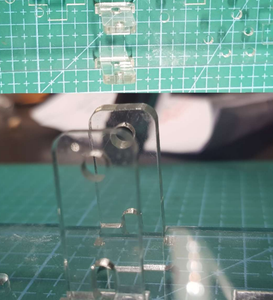

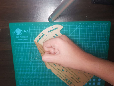

Step 1: Make the Car Base
1-REMOVE THE STICKER ON THE ACRYLIC

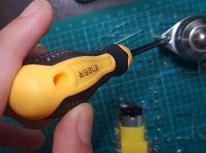

2-ADD THE T-PIECE ON ITS PLACE ON THE CHASSIS
3-ADD THE MOTOR BETWEEN THE 2 T-PIECES AND ADD THE TALLEST SCREW AND DO THE SAME ON THE OTHER MOTOR
4-ADD 2 SPACERS INFRONT OF CAR
5-ADD THE CUSTER WHEEL ON THE SPACER AND ADD A SCREW

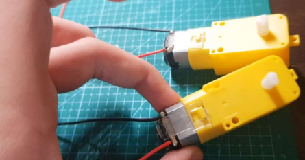

Step 2: Solder Motors
TO KNOW HOW TO SOLDER WATCH THE ATTACHED VIDEO

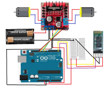

Step 3: SCHEMITIC
-HC-05
Tx to Rx on Arduino
Rx to Tx on Arduino
5v+ to 5v on Arduino
GND to GND on Arduino
- L298 MOTOR DRIVER
IN1 TO 10 ON ARDUINO
IN2 TO 11 ON ARDUINO
IN3 TO 12 ON ARDUINO
IN4 TO 12 ON ARDUINO
12V+ ON THE L298 TO THE POSITIVE OF THE BATTERY CASE
GND ON THE L298 TO THE NEGITIVE OF THE BATTERY CASE
SAME GND ON THE L298 TO GND ON ARDUINO
5V+ ON THE L298 TO VIN ON THE ARDUINO

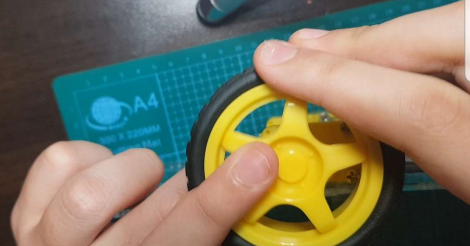

Step 4: ADD THE TYRES
Attach The Tyres To The Motor

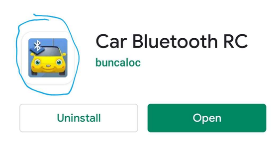

Step 6: Application
INSTALL THIS APP FROM PLAY STORE

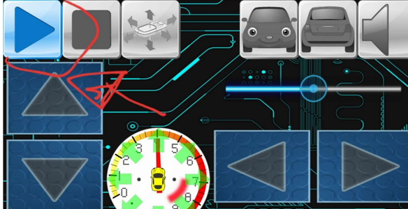

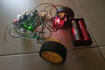

Step 7: Final Step
GO TO YOUR BLUETOOTH SETTINGS ON YOUR PHONE AND CONNECT YOUR BLUETOOTH MODULE ITS CALLED ( HC-05 )
AFTER INSTALLING OPEN THE APP AND PRESS ON THE FLIPPED TRIANGLE BUTTON
THEN CHOOSE HC-05
THEN HAVE FUN PLAYING WITH YOUR BLUETOOTH CAR
