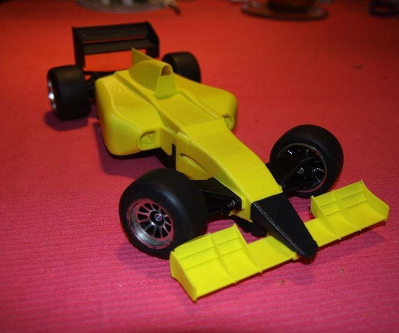

Introduction: HPD F1 Evo 1 Ball Differential Axle
This is the description on how to make a carbon rear axle to your HPD F1.
The design is very reliable and durable and gives you the advantage of changing diff/slip settings without disassembly.
This version is compatible with with F1 1.0 -> F1 evo.
Not for HPD Evo 2 and newer.

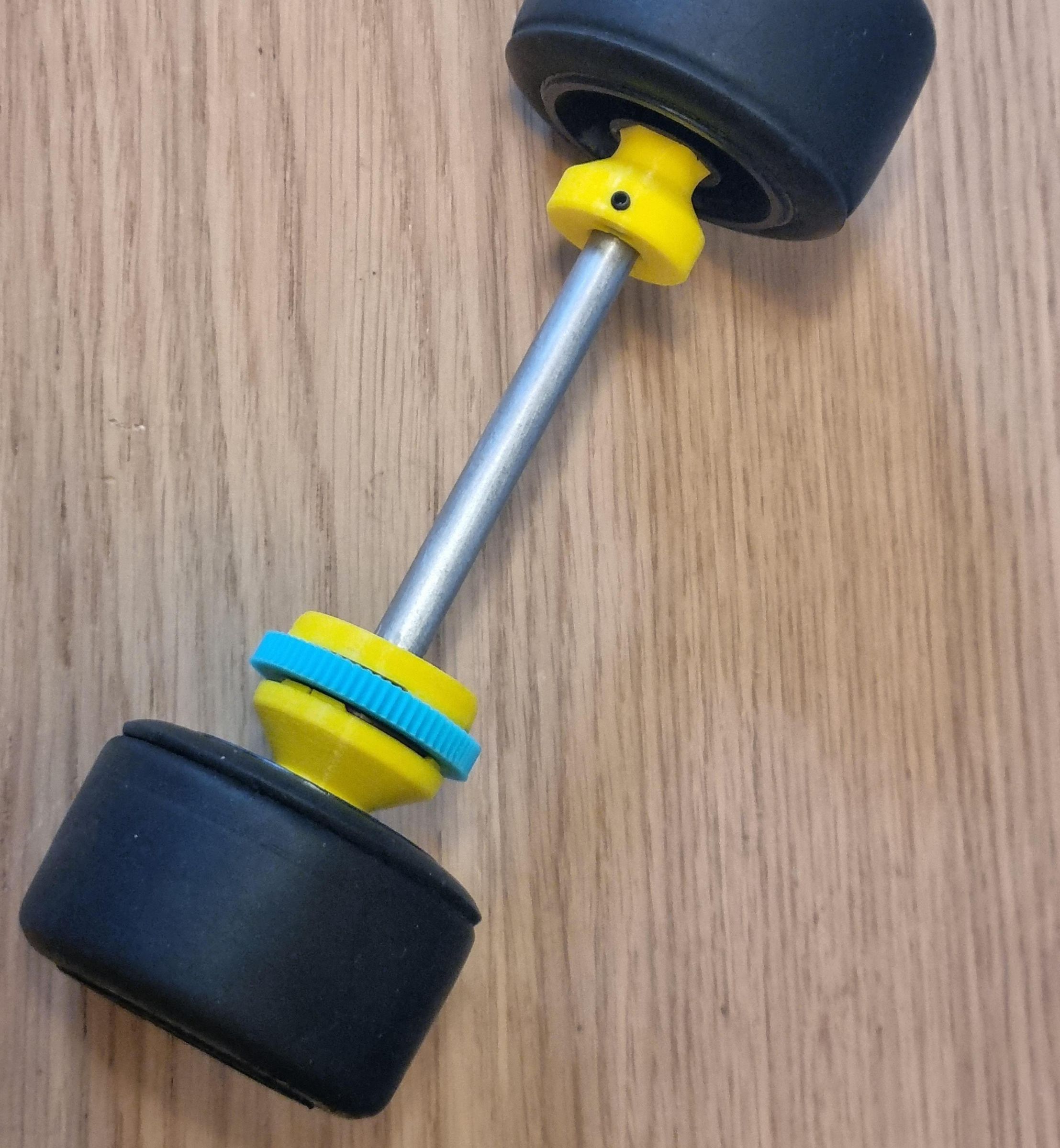

Step 5: Assembly of Axle
Glue axle
Use epoxy to glue the 6mm tube(s) inside the 8mm.
Use the jig to correctly place and glue the threaded rod
Observe that that it is not symmetrical. The end on the gear side sticks out longer.
Check that the resulting axle is still fitting inside the jig.
Glue indrive and gear seat
Use the jig to determine where to glue the in-drive.
Clean and grind the surface to make the epoxy stick optimally.
Put epoxy glue on the axle and inside the in-drive then mount it.Rotate the axle to see that you do not have a wobble.
Clean the excess glue.

Step 8: Differential Assembly (part 1)
Put into the indrive:
- The 2mm gasket.
- The diff washer.
Add diff grease on the diff washer, then:
Add the spur gear.
Step 9: Outdrive
Take the outdrive mounted on the wheel and put it on the table with the outdrive on the top.
Add in order:
- 2mm gasket.
- Diff washer
Mount all on top of the spur-gear.
Step 10: Diff Assembly (part 3)
Add the outdrive with wheel onto the spur gear on the axle.
Add the axial bearing on the axle as shown on picture.
Screw the nyloc M4 screw on place to keep everything together.

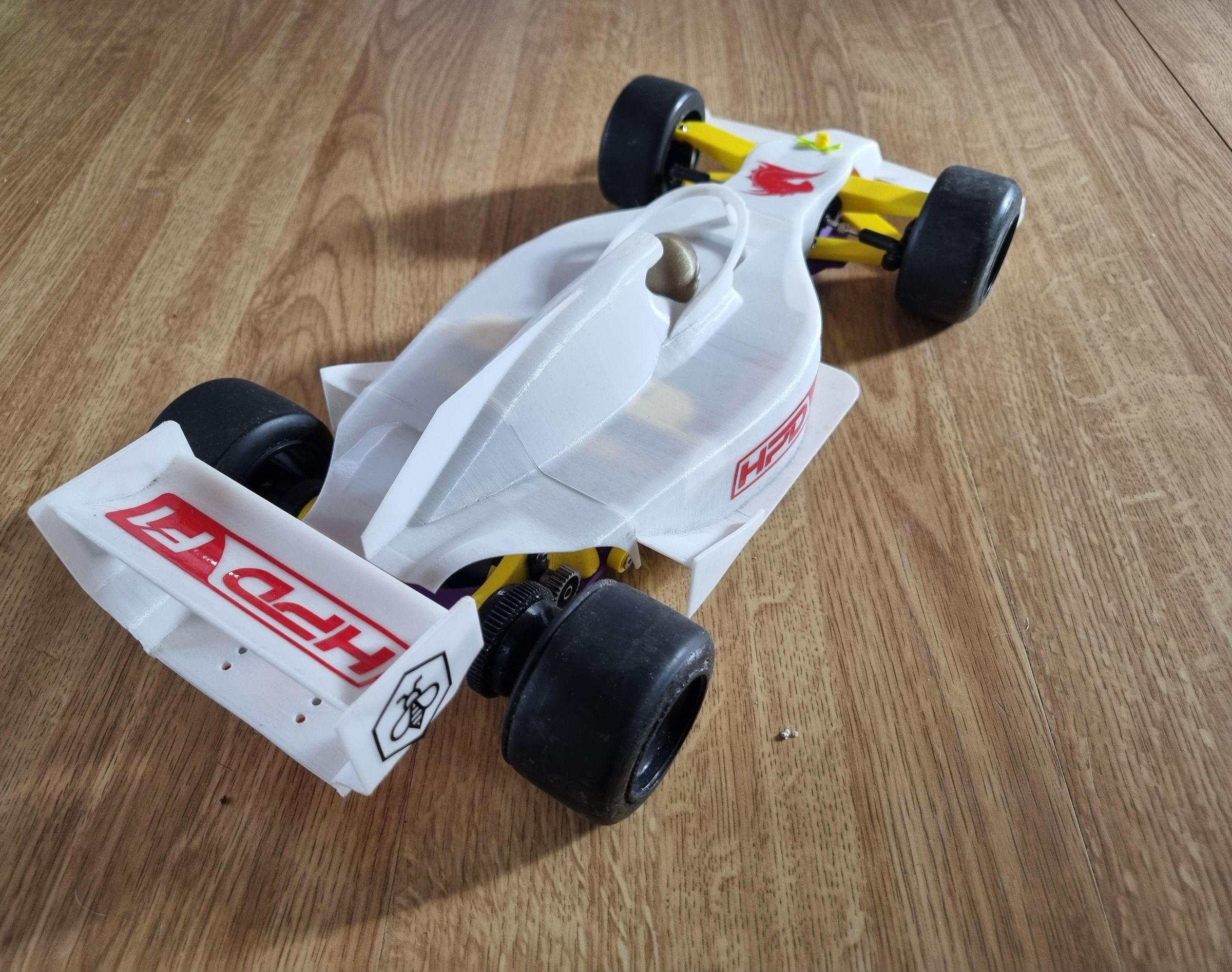

Step 11: Final Thoughts
Congratulations! You now have a very durable rear axle for the HPD range of F1 cars.
First a mention of the items printed but not used so far:
shim.stl: Is used to reduce play. Add suitable amount starting on the indrive side.
ball_bearing_adapter.stl: The carbon axle is 8mm instead of the 10mm printed axles on HPD F1 cars prior to version 3.0. Use this adapter if needed.
You will now want to adjust the slip/lock of the differential to adapt to the conditions on the circuit. This is done by changing how much you tighten then M4 lock nut on the differential side of the axle.
Because of the design you will be able to do it in seconds, not minutes.
