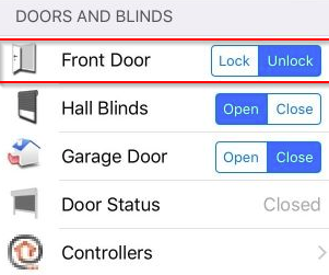

As stated earlier, this project will allow you to view your HRV control panel roof, house, control panel temperatures and fan speed in the OpenHAB GUI (in real time!) The images show what it looks like from my iPhone, plus the graphs you will get by drilling down into the different temperatures.
To get the graphs, you will need to also install and configure the RRD4J binding (this is very straight forward) This will allow you to click on either 'House' or 'Roof' and get a history of HRV temperatures for each over the past hour, day or week (or longer, if you alter the configuration to suit) The images shown are in celsius, and clearly its winter in the southern hemisphere when I made this!
Additionally, I created an OpenHAB view that shows a comparison between Outside temperature (provided by the Weather binding add-on, in my case using Wunderground) versus the roof and house temperatures by clicking on the 'Control' option (picture shows the graph with house, roof and outside temperature plotted). I plan on using this data in rules to turn on heating appliances as required. Simply add the Weather item to your Image URL in the sitemap file and include this on the same graph (eg: ...items=houseTemp, roofTemp, weatherTemp...)
