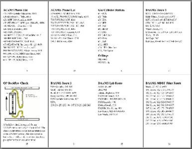

Project Goal: Create a 72-page, pocket-sized field book, with formatted pages that include graphics.
Easy, right? Fire up any standard word processing or desktop publisher, spend an hour and a half entering content, and perhaps another half hour to format and tweak page sizes and sections, another 30 minutes to print and staple together, and the project's done!

I work as a technician. I operate and maintain equipment that samples air. Everything we do is controlled by very official, frequently updated, Standard Operating Procedures. Highly classified and proprietary, of course. If I told you the details I'd have to kill you...that sort of thing (not really! Although, sort of...it's kind of complicated.)
Anyway, some of the stuff I need to know doesn't really change, not often, but it's not easy to memorize, at least not completely accurately. So, I keep a notepad handy. During my first year at work I wrote down important stuff in a 3x5 spiral notepad. When stuff changed, I scratched it out and added in the updated stuff. When the notepad was full, I got a fresh one, recopied all my important stuff and kept going.
After the first year, my important stuff outgrew my little notepad. It became a pain to recopy everything by hand. So, I cogitated how best to digitize my stuff.

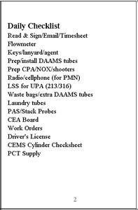

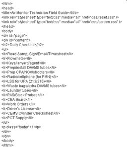

I created my HTML document. Here's the essential snippet. Feel free to copy, modify and expand.
<html>
<head>
<title>Air Monitor Technician Field Guide</title>
<link rel="stylesheet" type="text/css" media="all" href="css/reset.css" />
<link rel="stylesheet" type="text/css" media="all" href="css/screen.css" />
</head>
<body>
<div id="page">
<div id="content">
<h2>Daily Checklist</h2>
<ul>
<li>Read & Sign/Email/Timesheet</li>
<li>Flowmeter</li>
<li>Keys/lanyard/agent</li>
<li>Prep/install DAAMS tubes</li>
<li>Prep CPA/NOX/shooters</li>
<li>Radio/cellphone (for PMN)</li>
<li>LSS for UPA (213/316)</li>
<li>Waste bags/extra DAAMS tubes</li>
<li>Laundry tubes</li>
<li>PAS/Stack Probes</li>
<li>CEA Board</li>
<li>Work Orders</li>
<li>Driver's License</li>
<li>CEMS Cylinder Checksheet</li>
<li>PCT Supply</li>
</ul>
<p class="footer">1</p>
</div>
</div>
</body>
</html>
Of course, I had much, more more code than this. This was just the first page. I had 72 pages in my final booklet. I also had a cover page (with a cool graphic) and about 70 more pages after this. I didn't bother with meta-tags (I'm NOT going to explain what those are...not now, at least.)

<html>
Any internet browser (Explorer, Firefox, Chrome, Safari or a hundred more varieties) will respond to this tag by interpreting every other tag in the document as HTML code, displaying the document on a computer monitor as a webpage. The last tag on the document indicates the end of the HTML coding: </html>.
<head></head>
Everything between the <head> tags allows the browser to process the document according to specific rules. The information in the <head> section is normally never seen by the user who opens the document, except for the <title> information. The browser uses the <title> to display a short description of the webpage, usually at the very top tab of the browser window.
<link rel="stylesheet" type="text/css" media="all" href="html-css-publisher-reset.css" />
This line of code links the HTML document to a stylesheet called html-css-publisher-reset.css.
The reset stylesheet directs the internet browser to reset all formats and styles to a neutral or zero level. This reset is necessary the design of my booklet, because every internet browser is pre-configured differently by its maker. Internet Explorer formats HTML tags slightly different than Firefox, for example. Spacing and alignment are different, fonts are different, as well as many other style formats. Resetting all formats to zero makes all browsers essentially equal, at least for viewing on a monitor screen.
Immediately after linking my HTML document to the reset stylesheet, I also link to a stylesheet called html-css-publisher-screen. This stylesheet will define the formats and styles according to my own preferences. I can select font size, font type, spacing, alignment, colors...virtually every aspect of formatting can be customized. Since I've already linked to the reset stylesheet, my preferences won't be misinterpreted by different browsers.
After the <head> section comes the <body> section. The <body> contains the content of the document, the text and images that will be displayed on the webpage.
My HTML snippet displays one page of my field guide, the Daily Checklist that I review at the start of each day to remind me of what to get/do/consider. It won't make much sense to anyone else, but it does show you the HTML tags I used to display the information.

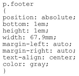

p.footer
position: absolute;
bottom: 1em;
height: 1em;
width: 67.9mm;
margin-left: auto;
margin-right: auto;
text-align: center;
color: gray;
This is the definition of the special class of paragraph that will display my page numbers. The position of the page number paragraph will be at the absolute bottom of each booklet page, spaced one em up from the bottom. The paragraph will only be one em in height, 67.9 millimeters in width, equally spaced from the left and right margins of the booklet page. The paragraph text (page number) will be aligned in the center of the page, and it will be gray in color.

p.footer
position: absolute;
bottom: 1em;
height: 1em;
width: 67.9mm;
margin-left: auto;
margin-right: auto;
text-align: center;
color: gray;
