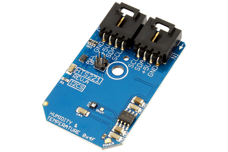

Step 2: About HTS221 Sensor
HTS221 is a Temperature and Humidity sensor by STmicroelectronics
Description
The HTS221 is an ultra-compact sensor for relative humidity and temperature. It includes a sensing element and a mixed signal ASIC to provide the measurement information through digital serial interfaces. The sensing element consists of a polymer dielectric planar capacitor structure capable of detecting relative humidity variations and is manufactured using a dedicated ST process.
Key Features:
16-bit humidity and temperature output data
SPI and I²C interfaces
Factory calibrated
For more information Download the Datasheet "CLICK HERE"

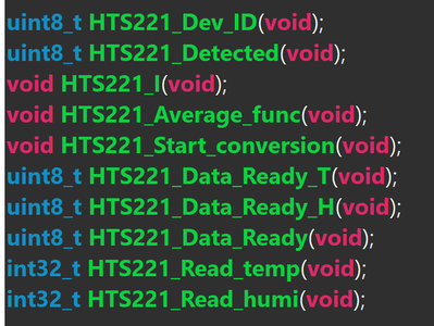

Step 5: HTS221 Supporting Functions
HTS221_I();
- Initializes the sensor and allows the user to change the output data rate.
- Sets ODR to 1Hz(default).
Input parameter - no input Arguments(updating....)
Output parameter - void
HTS221_Dev_ID();
- Returns the Device ID of HTS221 Sensor.
Input parameter - no input Arguments.
Output parameter - Returns Device ID(uint8_t)
HTS221_Detected();
- Returns 1 when HTS221 is detected.
- Returns 0 when HTS221 is not detected.
Output parameter - Returns 0 or 1(uint8_t)
HTS221_Average_func();
- Performs Average for Temperature and Humidity values internally.
- Makes 16 Temperature Average and 32 Humidity average.
Input parameter - No input Arguments
HTS221_Start_conversion();
- In oneshot mode the conversion has to be started manually.
- After every ADC conversion Bit0 of Control register 2 in HTS221 sets to 0.
- This function sets the required bits and starts the conversion.
Input parameter - No input parameter.
HTS221_Data_Ready_T();
- This functions check the availability of Temperature data.
- When the users reads the data, the output will be zero when the ADC conversion has not completed.
- After a successful read the data stored in the register sets to zero.
- This function will make sure that the user reads the valid data.
Output parameter - Returns 1 or 0 (uint8_t)
HTS221_Data_Ready_H();
- Same as before but this time it will check the availability of Humidity data.
HTS221_Data_Ready();
- This function will check the availability of Temperature and Humidity data.
HTS221_Read_temp();
- Reads the 16-bit Temperature data from HTS221.
- Performs linear interpolation.
Output parameter - Returns calibrated Temperature data(uint32_t)
HTS221_Read_humi();
- Reads the 16-bit Humidity data from HTS221.
Output parameter - Returns calibrated Humidity data(uint32_t)
