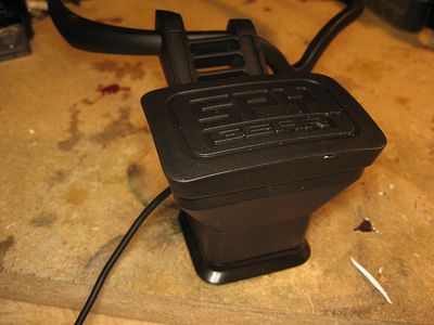

As the first thing, you want to get the big cover off, so you can get to the circuit board and the LCD. The cover is glued to the eye piece so apply force & Use just the tip of the normal screwdriver. The circuit board is about 7mm under the cover, so be careful.

Unscrew the two screws. When you don that, unplug the LCDs ribbon cable first. Just gently push the dark piece to right. Do not remove it & just push = it will slide and release the ribbon cable. Take the circuit board away by pulling by the cable.

After removing the circuit board, unscrew the four screws, that are holding the LCD with the viewfinder (magnifying glass) and take it out.
