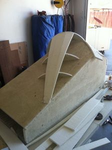

The following pictures show the process. I made a foam mock up of the inside of the duct starting with a base and 19” round to represent the “in” and “out” of the duct. I used blue non–beaded foam.
After the air handler was mounted on the roof with the plenum in place these first two pieces of foam were placed in position in the attic space and joined. Then back in the shop I added foam to fill in the perimeter. The surface imperfections were filled with drywall mud. The whole thing was then painted 2 coats with latex paint to protect it from the vinyl ester resin used in the fiberglass process.

Step 2: Filling in the Mold, Starting to Take Shape
Thin foam is added to create a smooth transition. I used gorilla glue that foams up to assemble, it fills and sands easily.
Step 3: Smoothing the Contours
I used drywall mud to fill in all the imperfections and create smooth contours for the airflow. The easier the air flows the less energy is used.

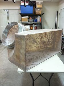

Step 5: After the Resin Has Cured
I did not explain how to fiberglass the plug, that is another topic in itself. After the fiberglass has cured the foam is chipped out and cleaned up with acetone. Then the entire interior is sanded, remember airflow likes a smooth surface. The 18" metal start collar is now added and a few layers of fiberglass to secure it.
Step 6: Paint the Inside
Use a good quality automotive paint for the inside to get a smooth finish.
